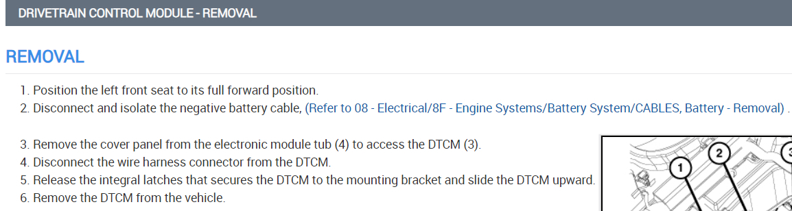

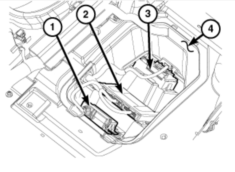

Yep, the transfer case control module DTCM is in the lower seat well on the drivers side and can get moisture in it, here is the location of the transfer case module so you can check it out.

Yes, the problem should be the DTCM near the driver's seat. Sorry for the confusion.

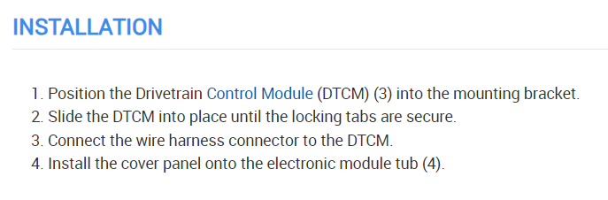

Hi. I got today DTCM from dealership. I changed it myself, voila.... The noise is gone.... 4wdLow is engaging..... 4wd Service light is gone. Thank you very much... For your help and pinpoint diagnosis...
