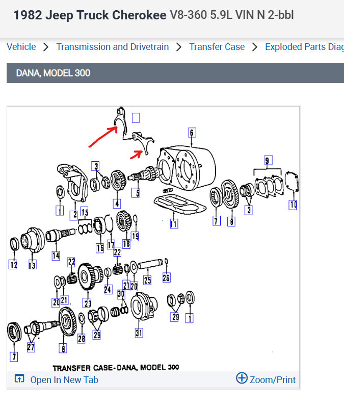

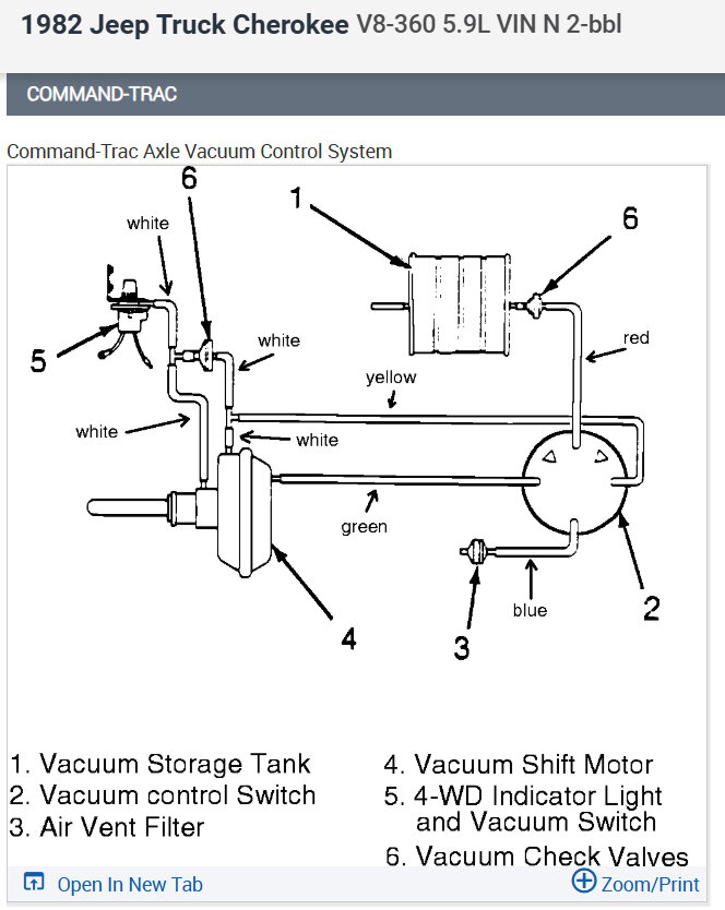

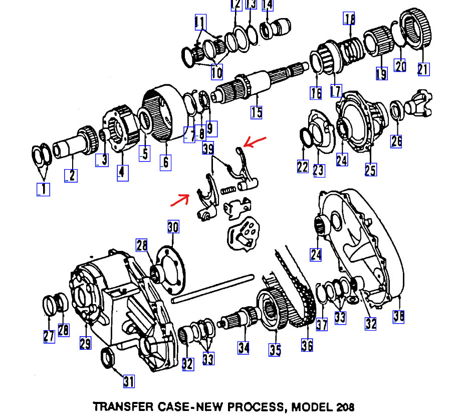

The car will drive around fine, shift through all the gears great but intermittently it makes a clunking noise like something disengaging and slipping back in, and it is loud, along with that it also makes a high-pitched grinding noise. We originally thought it was the rear output shaft retaining ring but it’s not. It is also the np219 so full time 4wd and the problem happens in all settings high lock, high, low lock. Thanks
