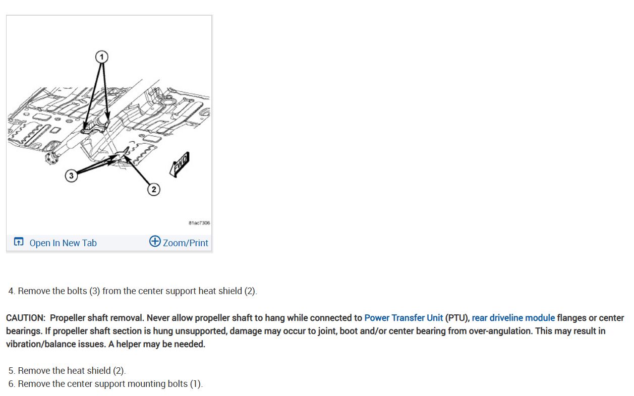

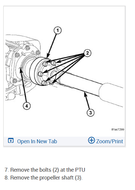

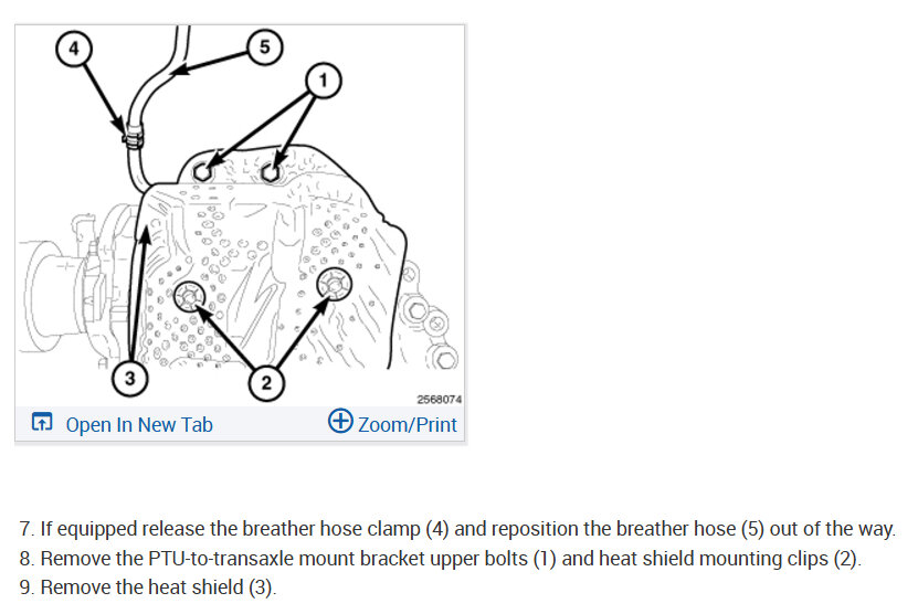

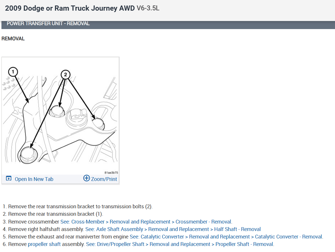

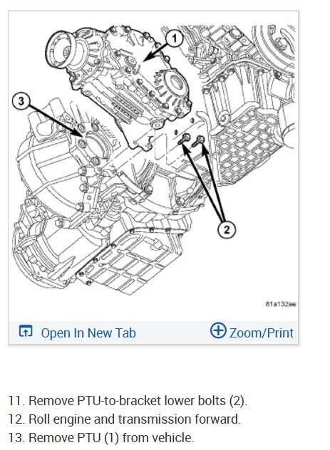

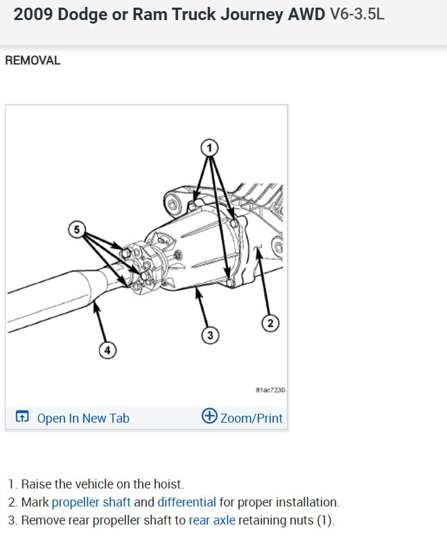

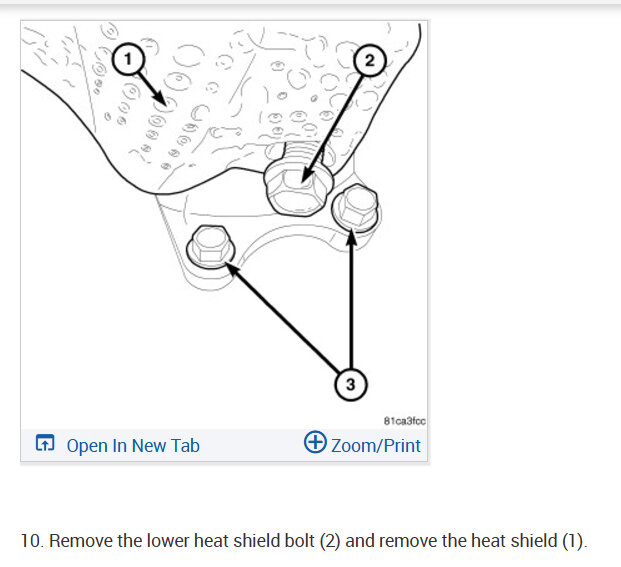

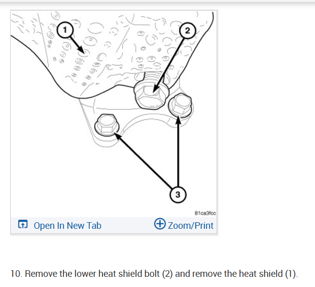

All you can do is try it. I would remove the rear driveshaft and see if the car operates in a normal way. You may get some warning lights which is to be expected. Here is how to change out the transfer case which you can find a used one by searching ebay and how to remove the rear drive shaft to see if it works. Check out the images (below). Please let us know what happens.
