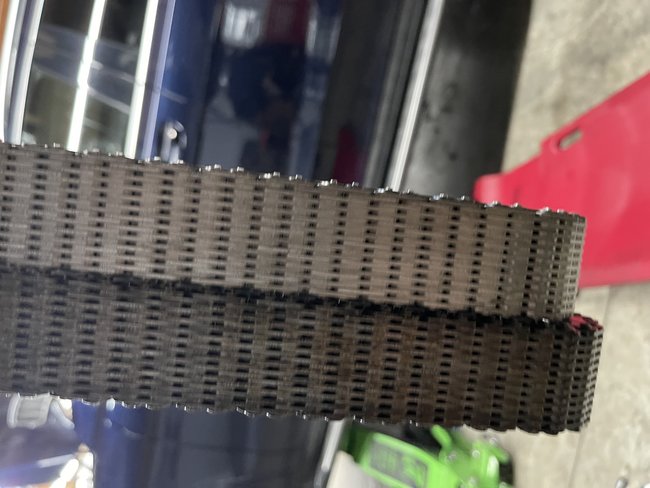

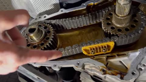

Okay. That helps. Then yes it looks like that chain is slapping the case. It is unlikely to be slipping because those think chains will damage the teeth of the gears and you would see that.
Take a look at the case and surrounding parts and see if there are any witness marks that would be the chain slapping.

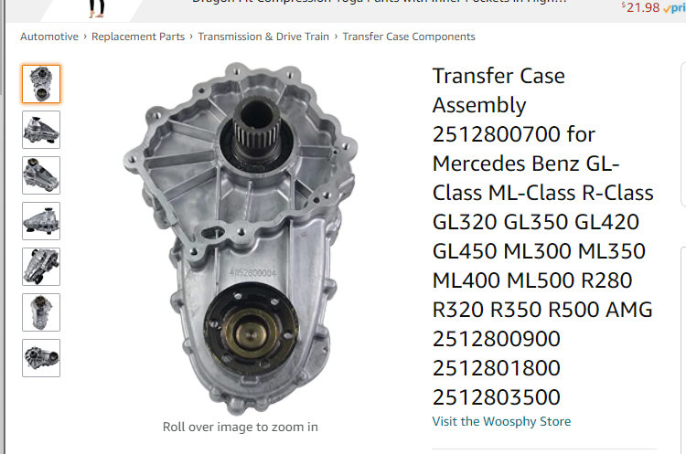

If you see nothing, then I suspect the transfer case if just worn out.
That is very common with AWD vehicles and there is no info on rebuilding them.
I am sure you can, but you would have to find parts and then work through it. MB says to replace them.

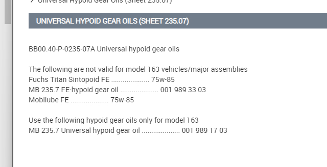

As for the fluid, if it came out fast then that is ATF. No question.
