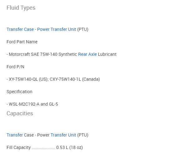

What fluid goes in the Lincoln MKX 2008/Ford Edge 2008 3.5l v6?
Apr 1, 2020 at 8:11 AM
CERTIFIED EXPERT
18,907 POSTS
I attached the spec and info for this. I wasn't aware but they call for actual rear axle fluid. Part number for Ford is there along with what the fluid requirement is if you want to use a different brand.
Let me know if you have questions. Thanks

Thanks. just confirming and you've solved my doubt. Always awesome to hear from you. Stay healthy Ken.
