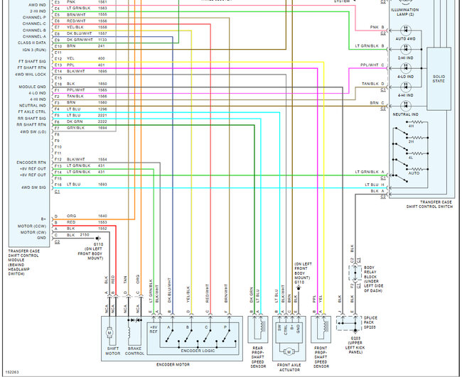

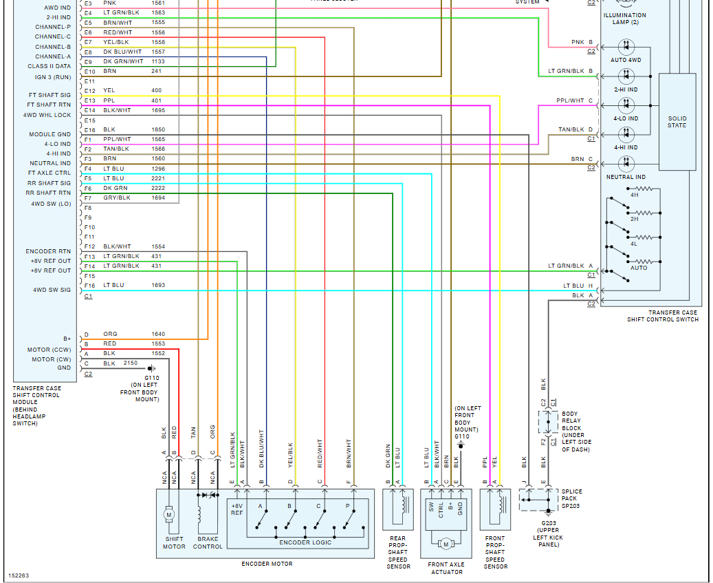

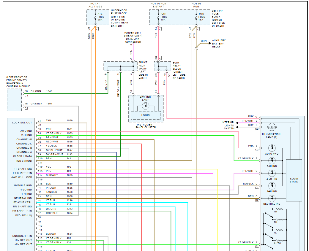

Need a wire diagram for the transfer case, I just replaced the transmission and forgot to mark wires before pulling it.
Feb 9, 2025 at 12:56 PM
Sure, here are the wiring diagrams for your truck transfer case. Check out the images (below). Let us know if you need anything else.
