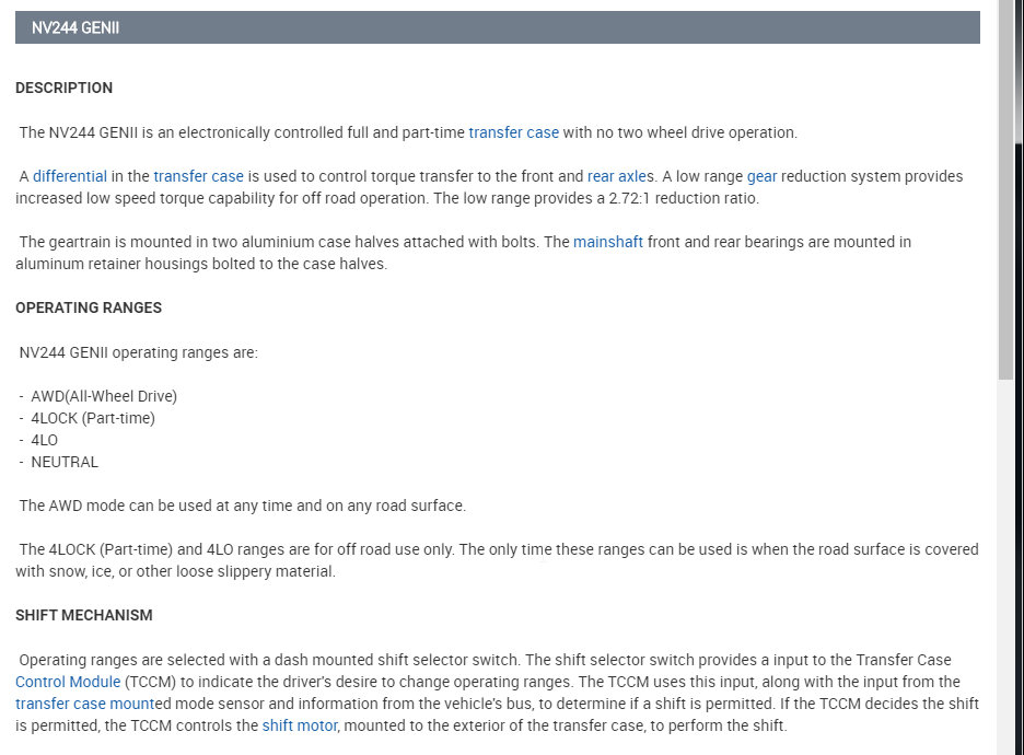

If you have the 244 then you have AWD, 4LOCK, 4LO, and Neutral, correct?

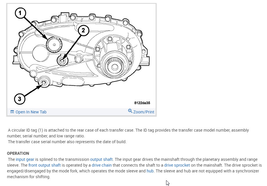

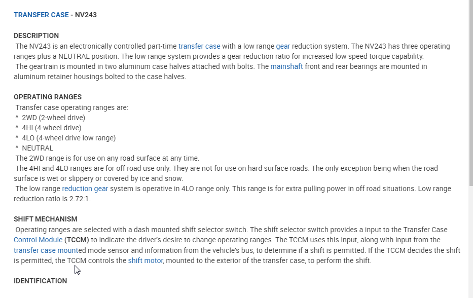

The 243 is different. It is actually a 2WD, 4HI, 4LO, and Neutral. So unfortunately it may bolt up but will not function the same with the controls through the Transfer case control module.

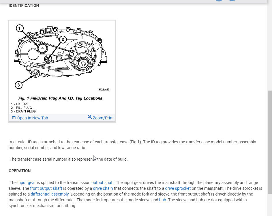

Here is the detail about both transfer cases. Let me know if you have questions.
