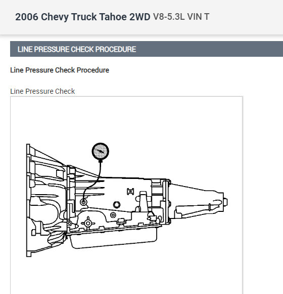

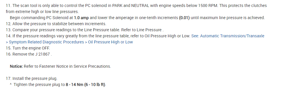

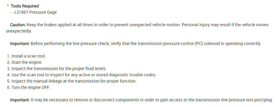

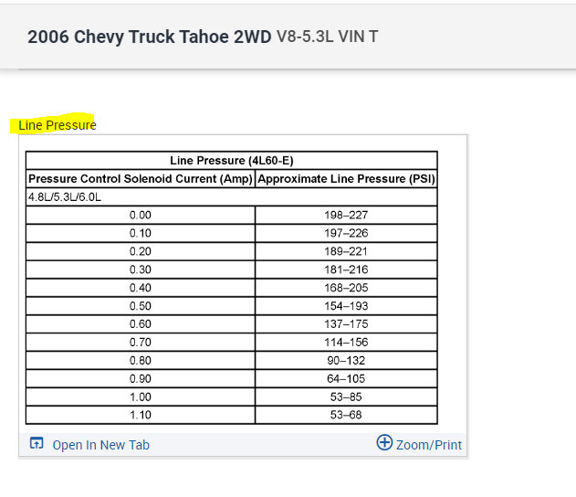

I attached diagnostics for testing pressure below. Take a look at them and let me know if that is something you feel comfortable performing.
See pics below.

Line pressures are falling within acceptable ranges according to specs uploaded. Tahoe hasn't presented problem at all today. I just don't know. Maybe electrical? That's about only thing left? Pure D ass befuddled, I am.
