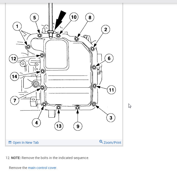

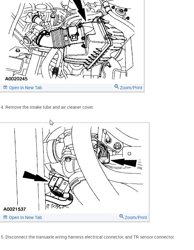

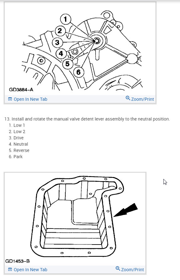

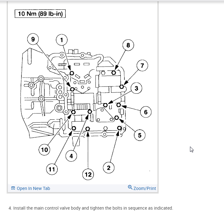

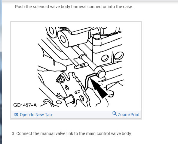

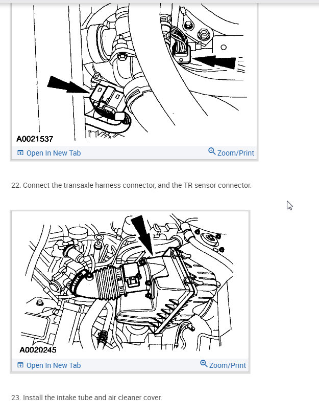

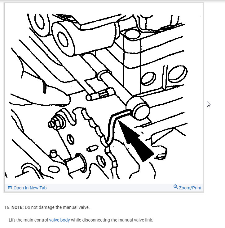

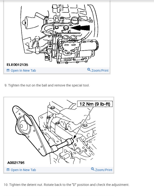

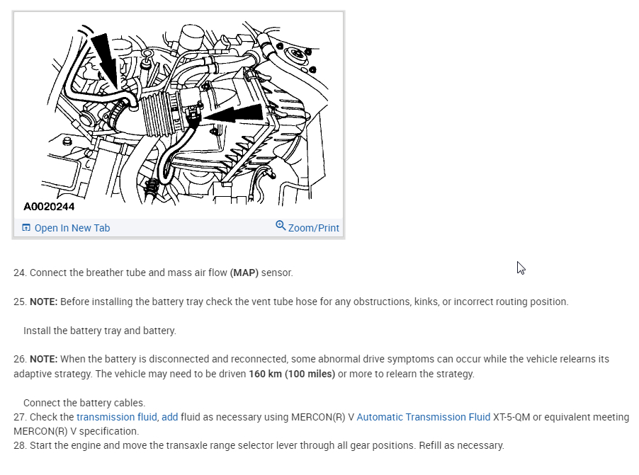

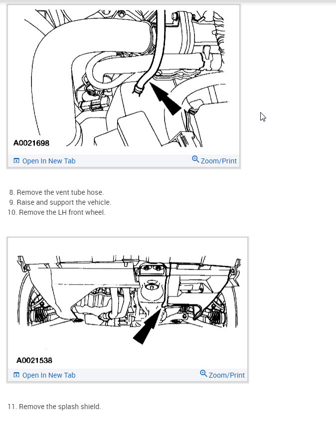

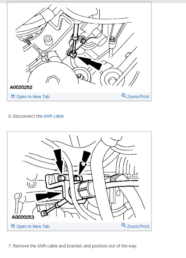

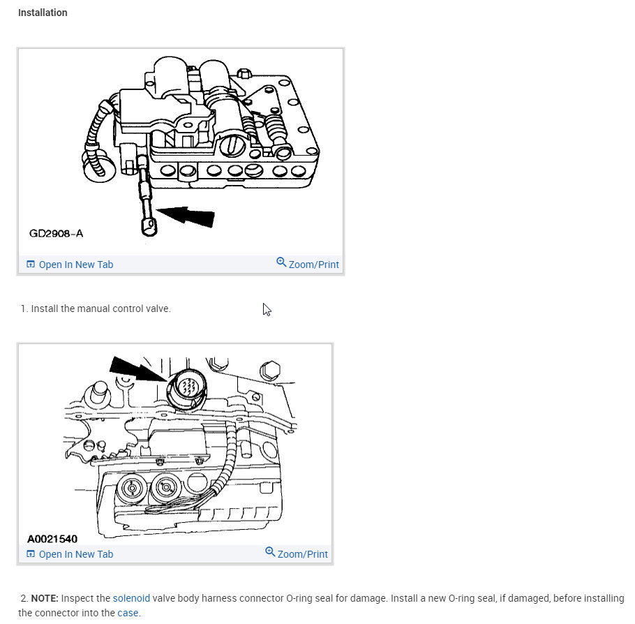

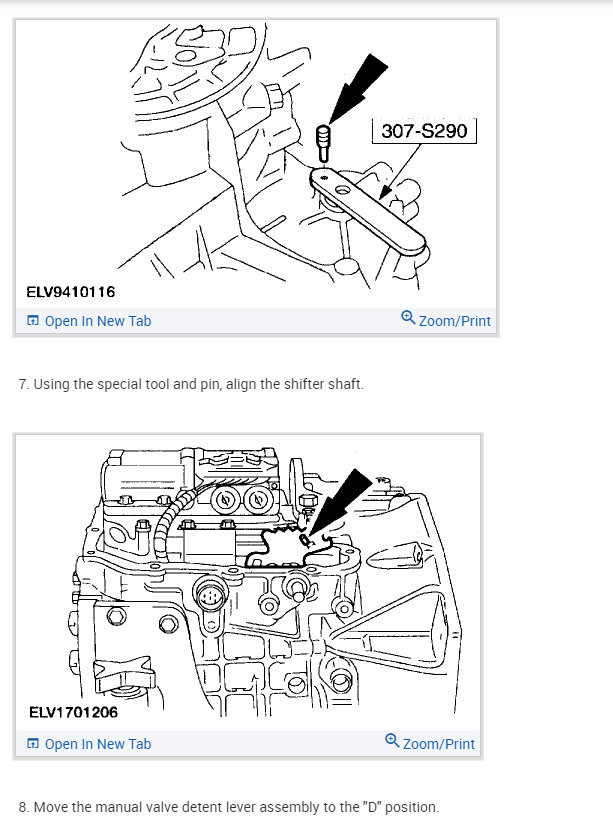

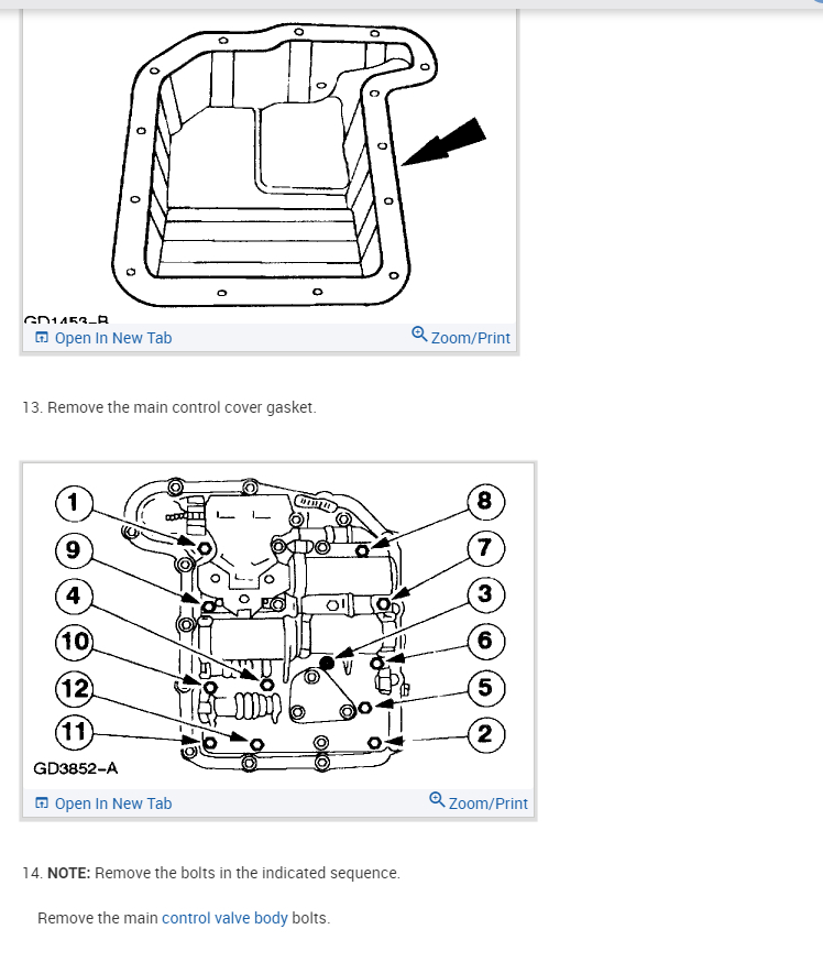

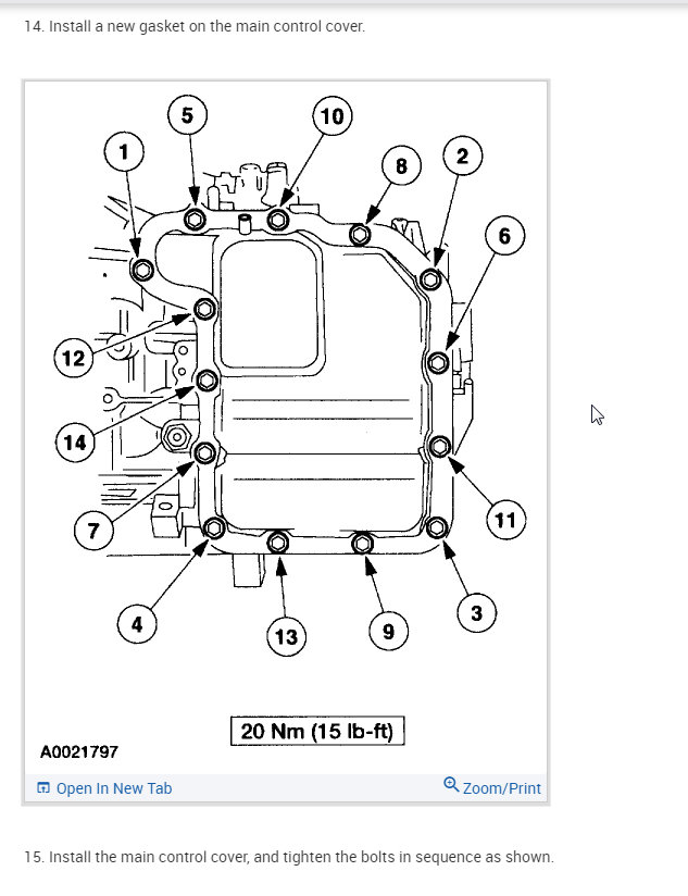

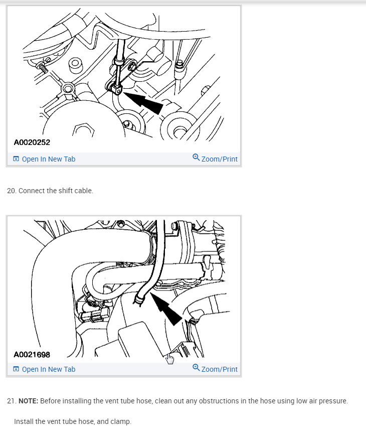

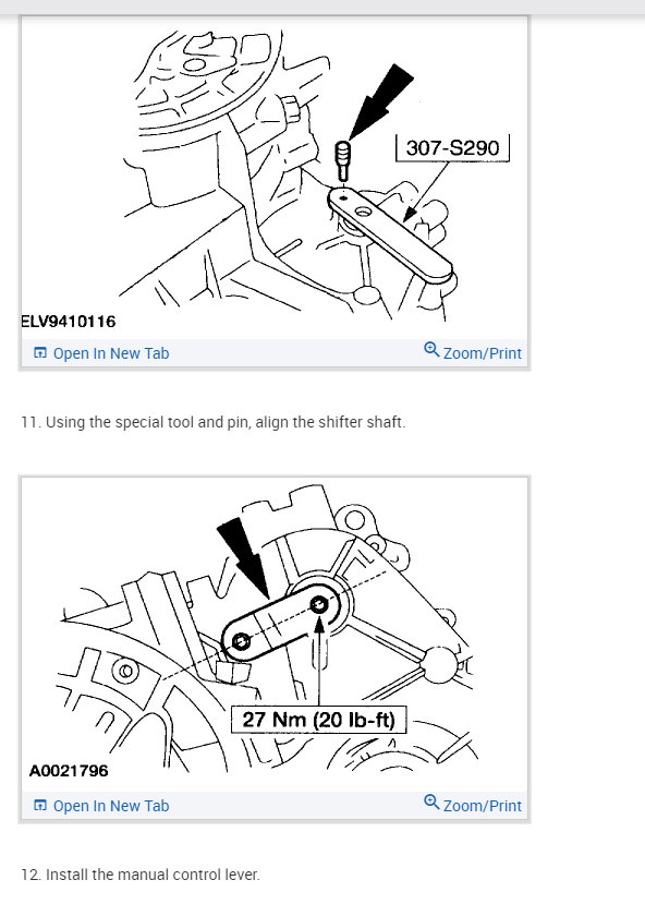

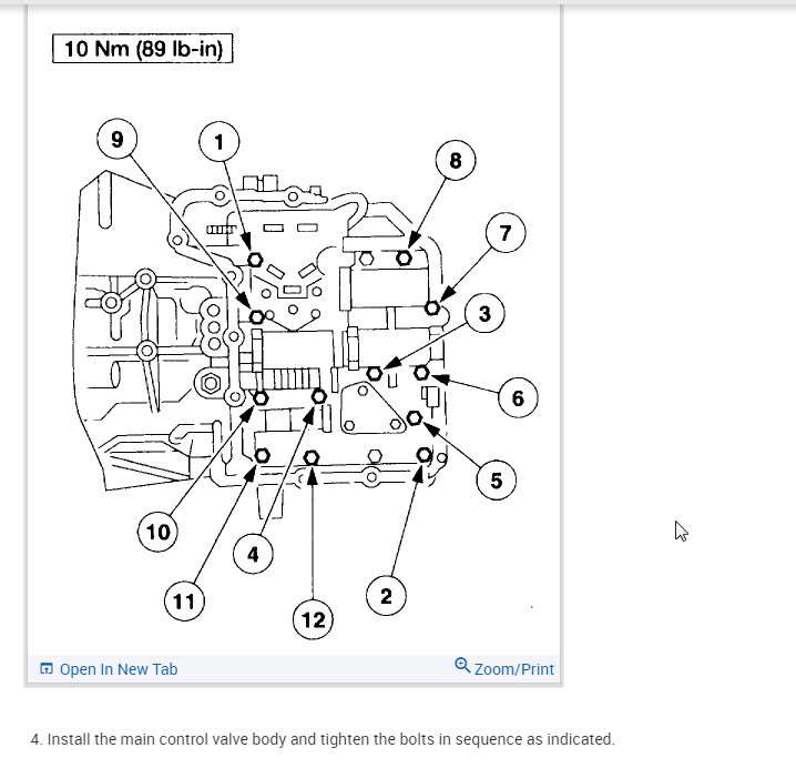

can they be replaced without removing the transmission?
Jun 22, 2019 at 7:12 AM

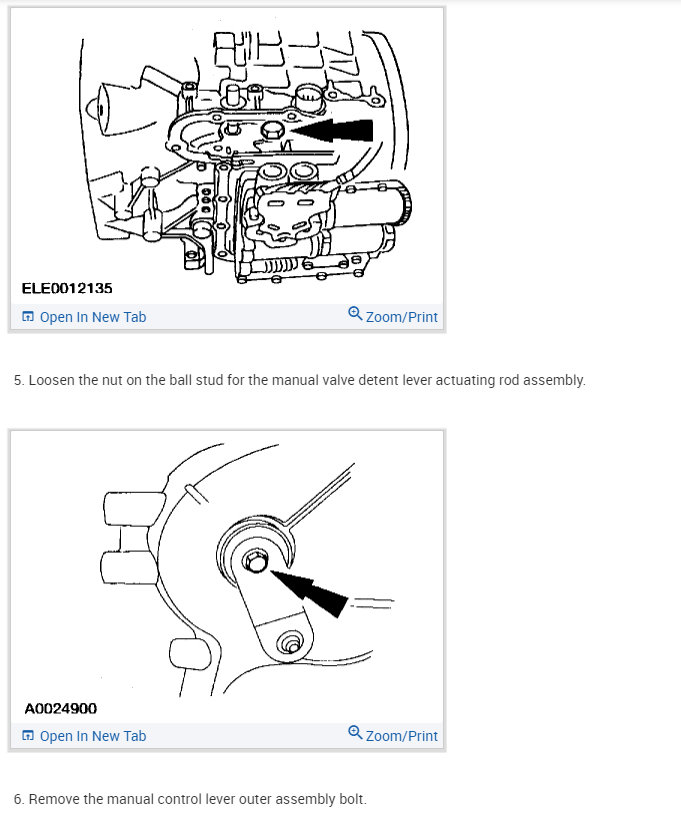

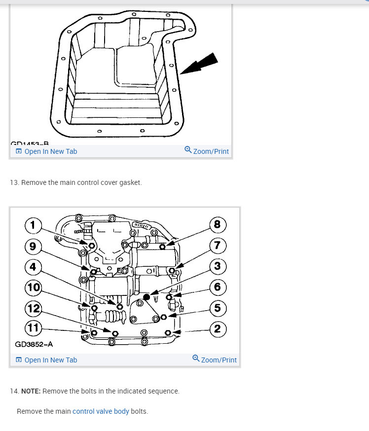

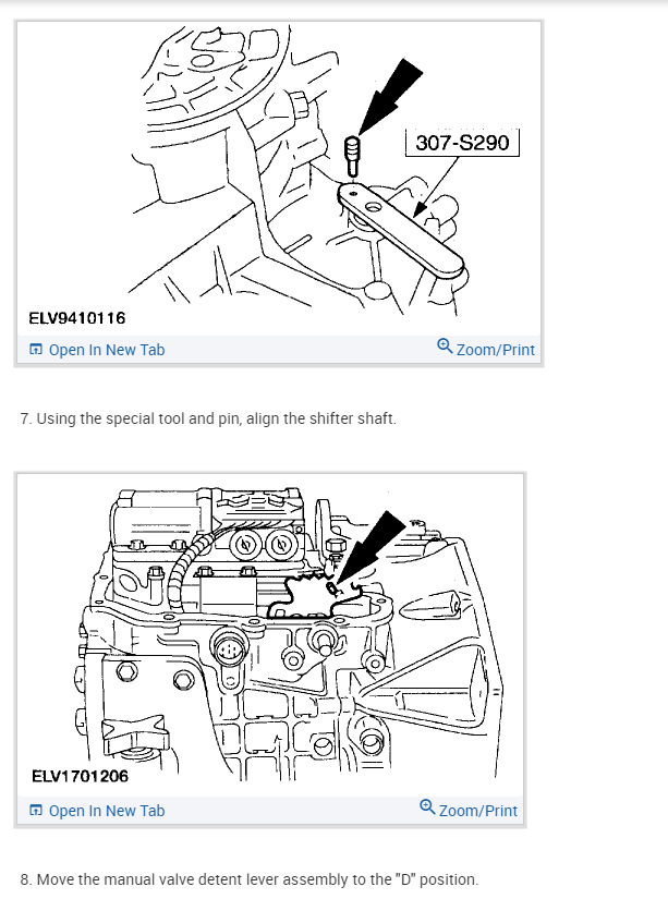

Hi Byron,

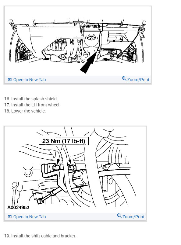

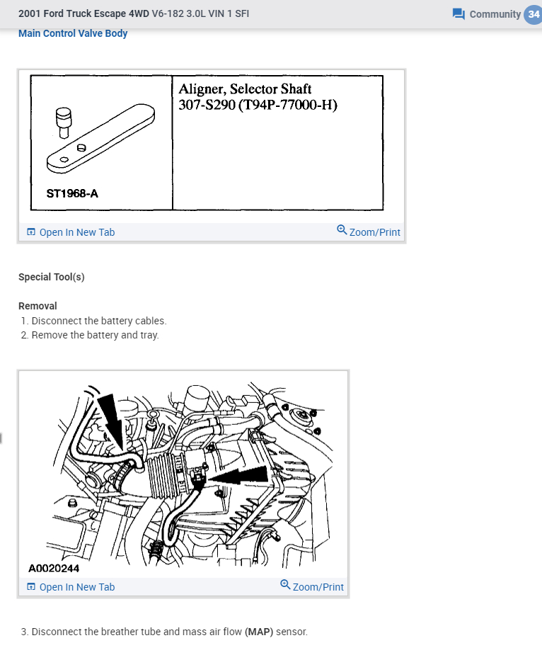

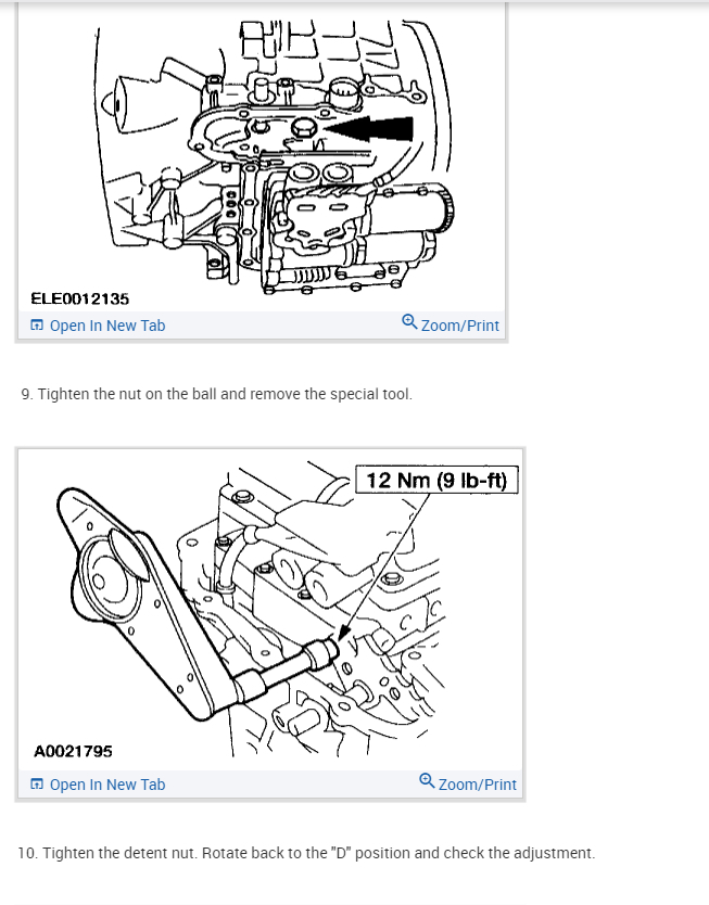

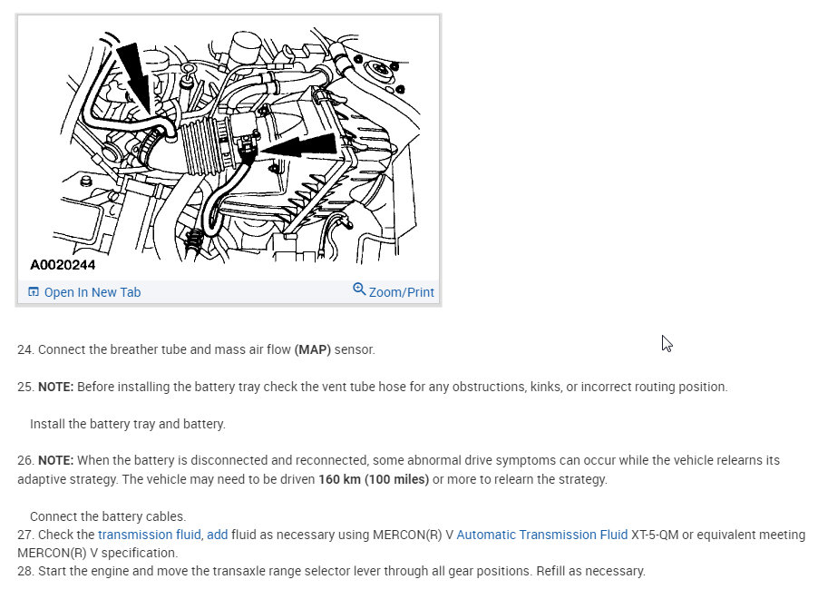

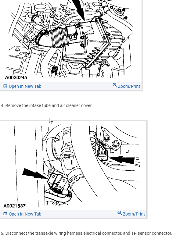

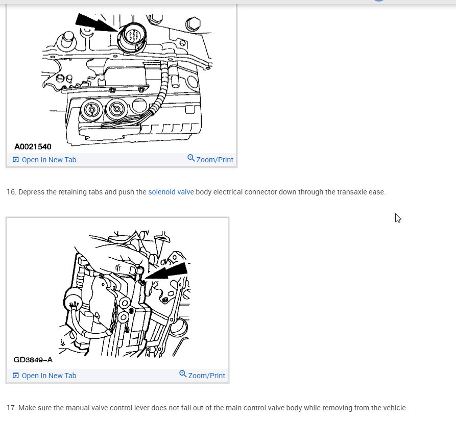

I assume you are talking about the shift solenoids that are in the valvebody? If so, I included the procedure on how to remove the valvebody and reinstall it and yes, you can do it without removing the transmission.
Please let me know if you have any other questions on this issue. Thanks
