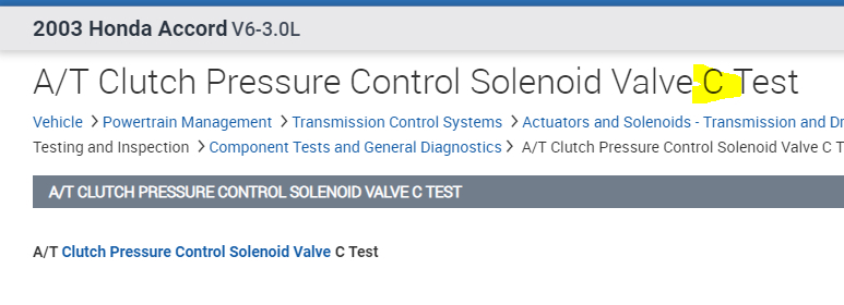

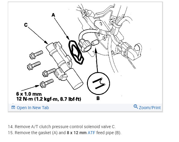

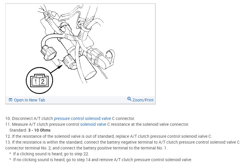

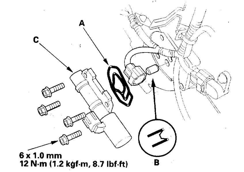

I attached a pic below of the A/T clutch pressure control solenoid. Take a look and confirm that is what was replaced. Keep in, there are three, A/T Clutch Pressure Control Solenoid Valve A, B, and C. So, if you have a diagnostic trouble code, let me know what it is.

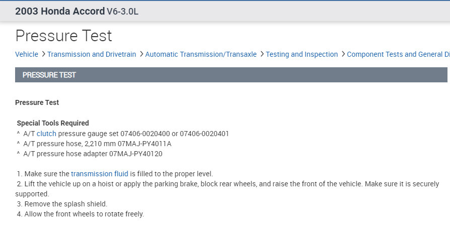

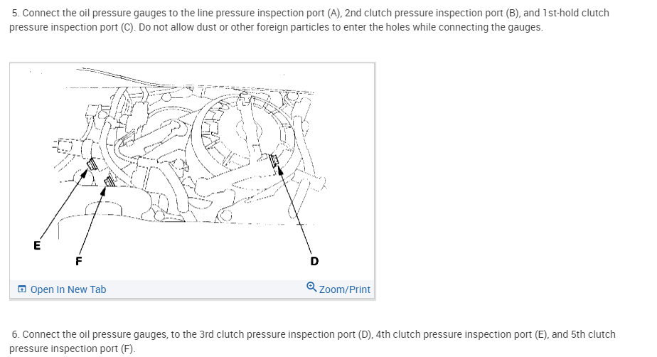

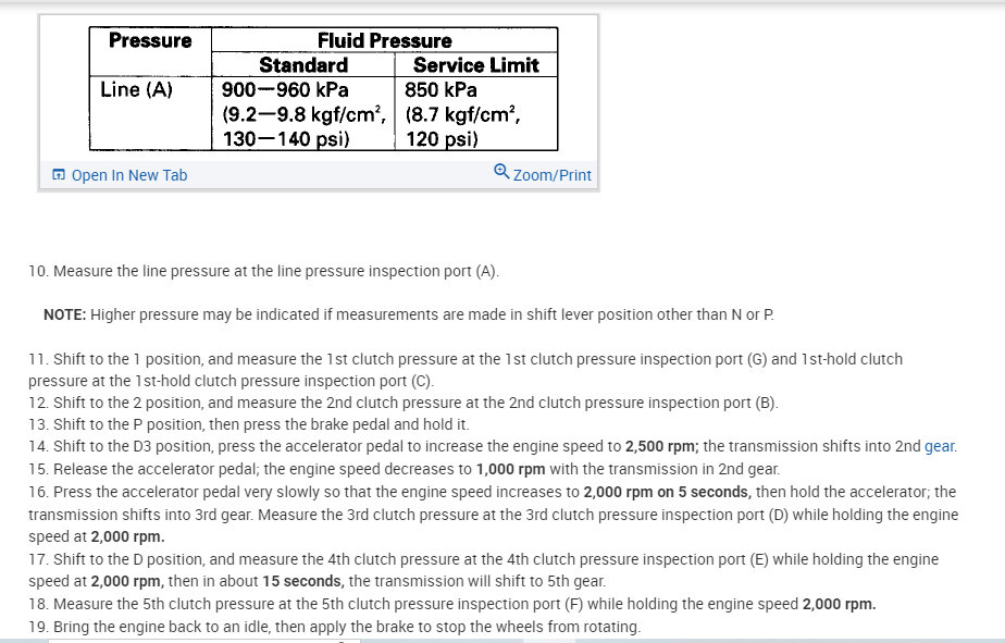

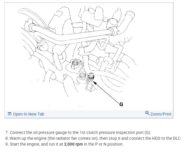

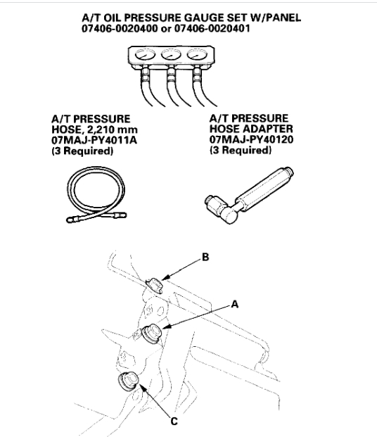

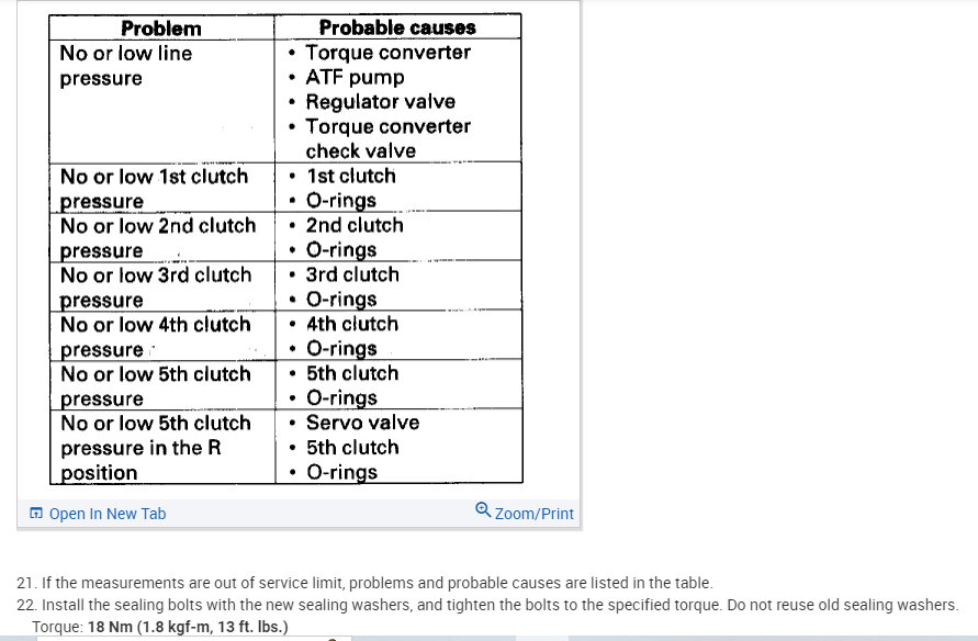

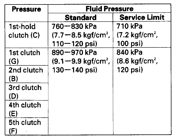

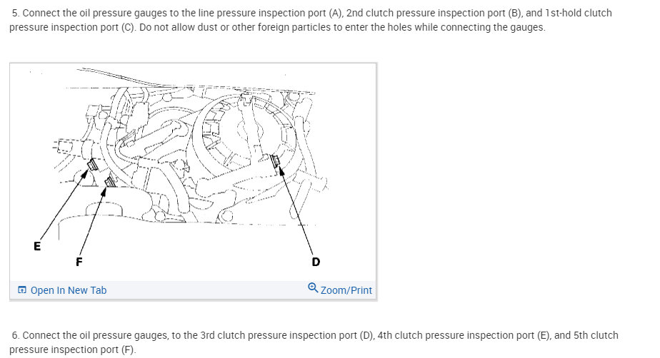

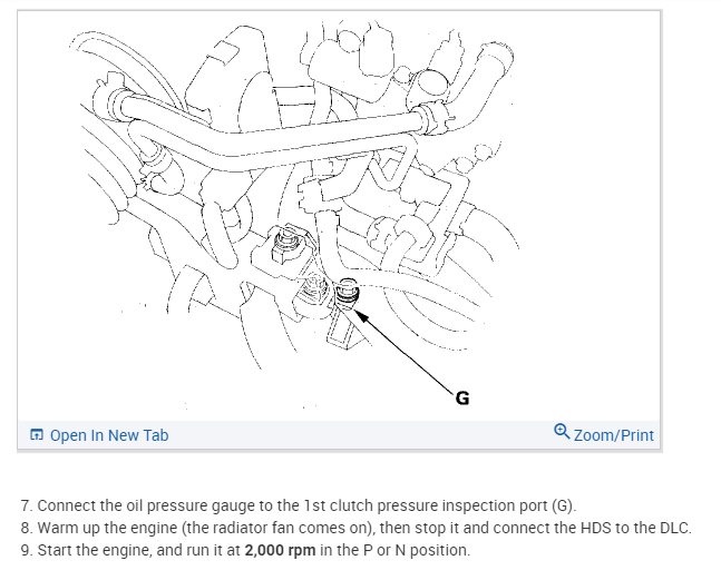

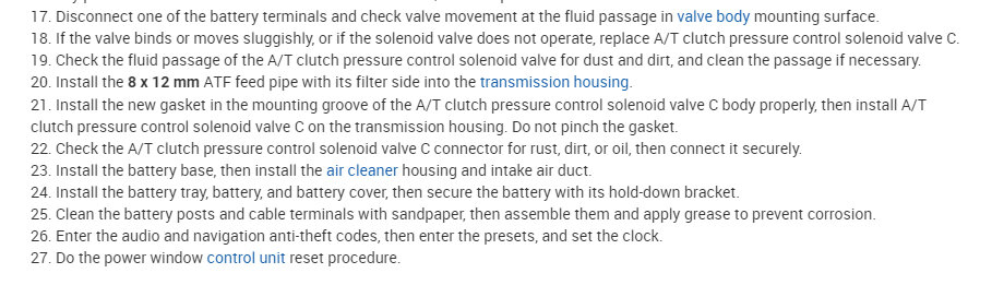

If you can't have that done and you are still getting a pressure-related code, let me know what it is, or you can check the line pressure and see if it is within the manufacturer's pressure specifications. I attached the directions below explaining how it's done.

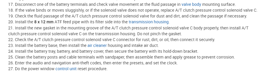

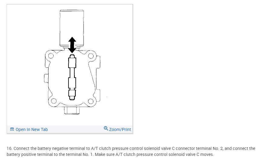

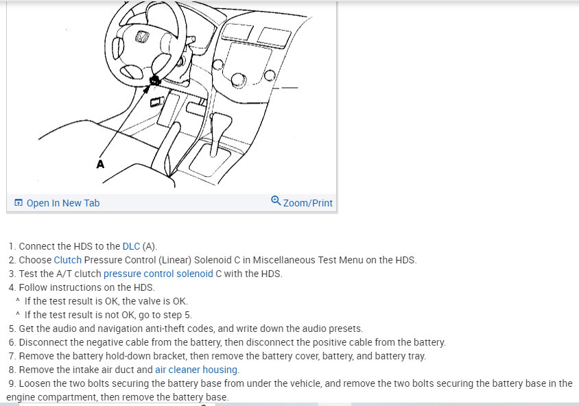

See pics below. Note: There are two tests. One is for solenoids A, and B, and the other for solenoid C.
