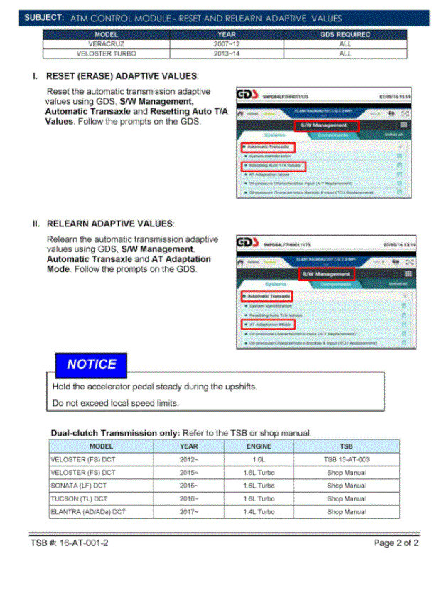

Also, you can reset the transmission control module, but it does require a scan tool that can communicate with it. I don't know if you have one or not. There was actually a technical service bulletin out indicating this needs done. I attached it below. However, I don't know if it would prevent shifting altogether. Take a look through it.
See pics below.

This was only a technical service bulletin. Is there someone that you know that can try the reset? Also, how long did the new transmission work?

Try the reset and see if things work properly again. If they do, then it's not the transmission but something electrical. Let me know what you find. I'm interested in knowing.

Thank you. The car is shifting like it should now, but for how long? I have a feeling I will try the reset soon.

I'm glad to hear that, and you are very welcome. As far as how long it will remain working, that is a tough question. It may fail again, or it may never happen again. However, if it does happen again, there should be diagnostic trouble codes stored. So that is the first thing which should be checked.
Let's just hope it never happens again and it simply needs to be reset.
