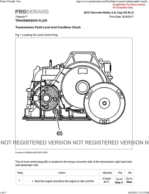

How do i check transmission oil level?
Aug 29, 2017 at 7:29 PM
HARRY P
  • 2,292 POSTS

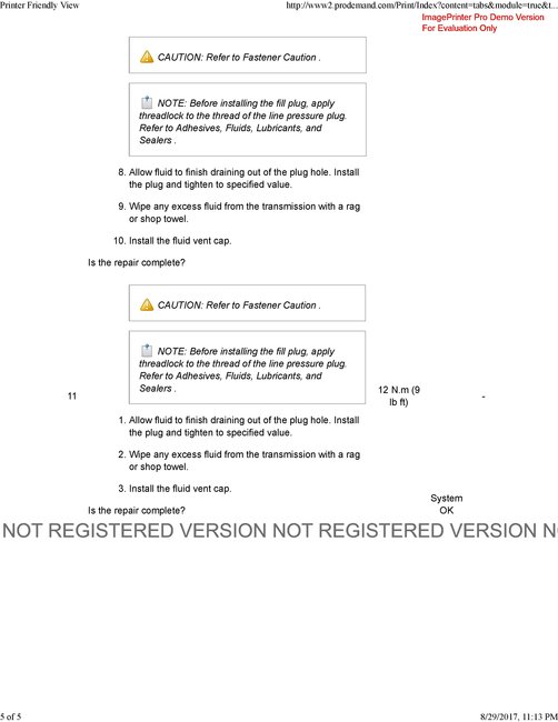

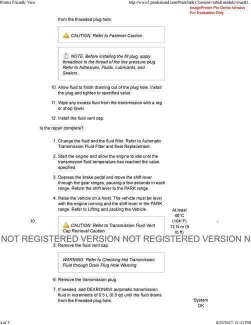

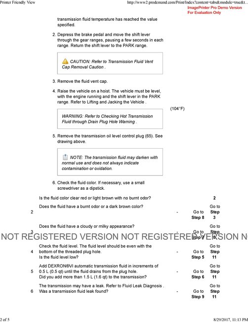

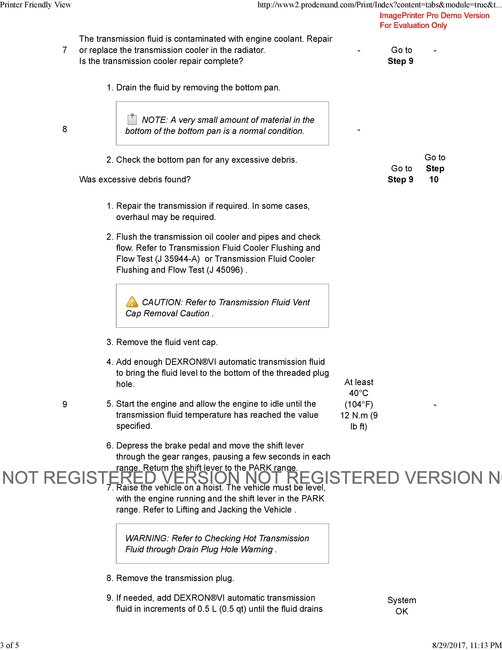

Unfortunately, your car does not have a simple dipstick for checking the transmission fluid level. I have attached a guide to checking you car's fluid in several image files.
Unfortunately, this is the way many cars are built now.
