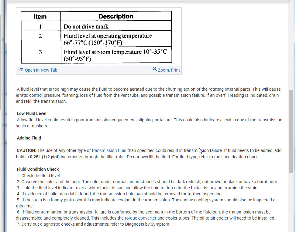

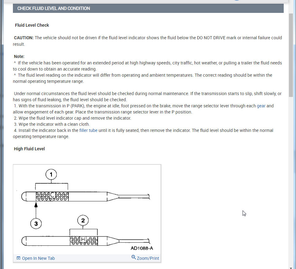

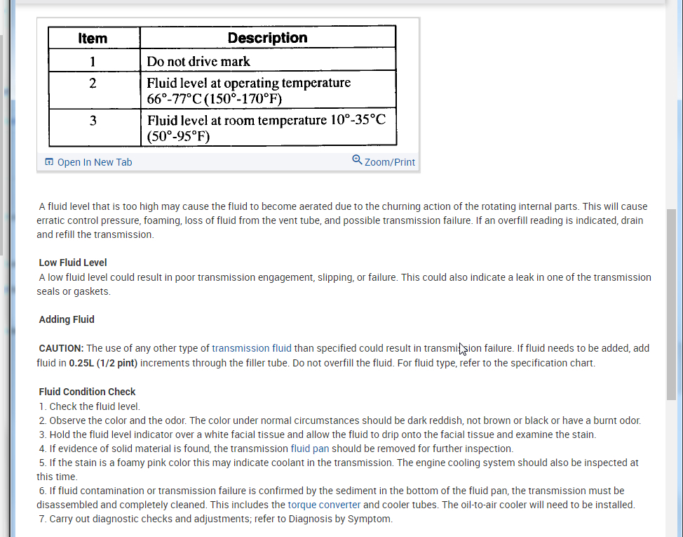

I am attaching the info from the manual on how to check the transmission fluid on the 4R70W which is what your vehicle would be equipped with.
Please let us know what other questions you have on this and we can go from there.
