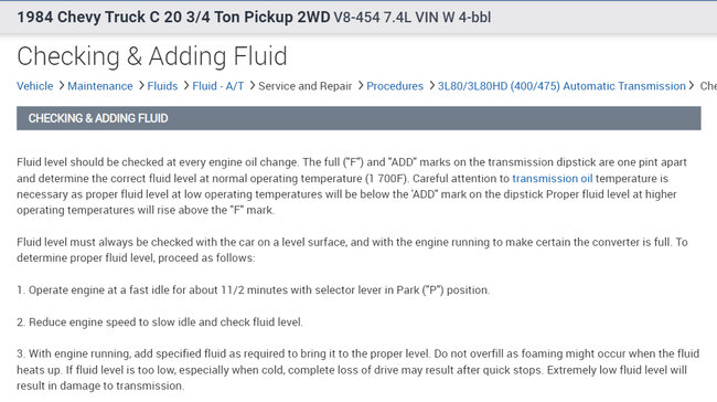

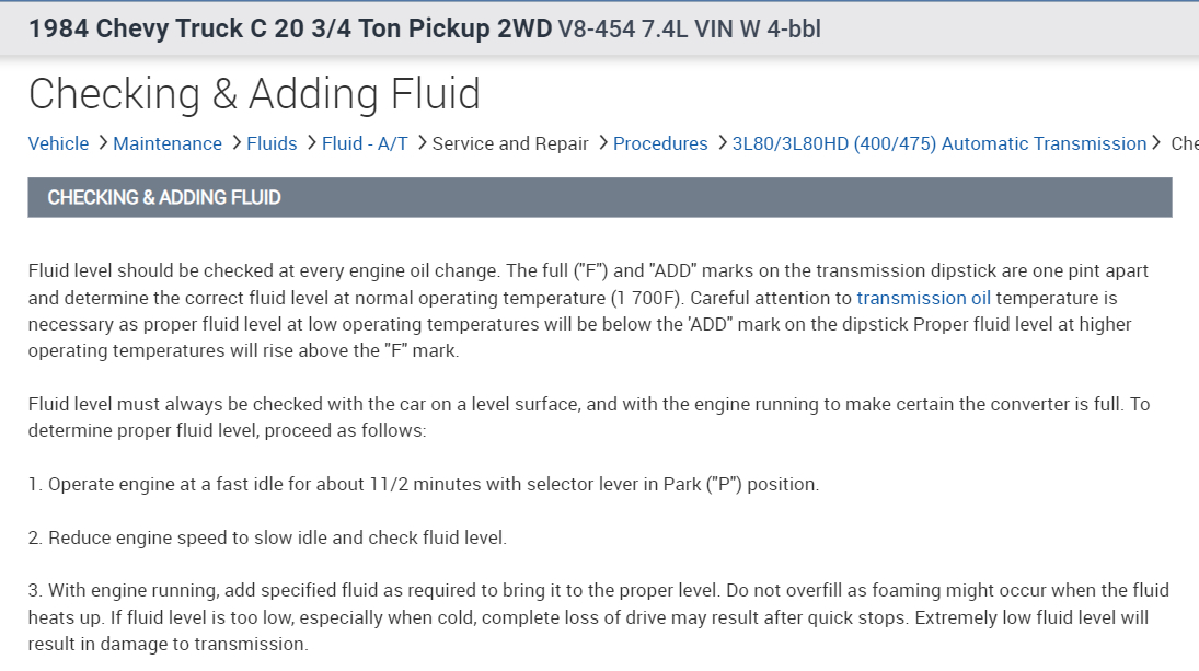

Interestingly, the manual doesn't have the specifications for a service. I know it holds 11 quarts of it is totally dry, but that isn't the case when you drain it.
Here is what I suggest. Start by placing approximately four quarts to start. Once you add the fluid, follow the directions I attached below. Also, it doesn't mention it, but I would shift it through the gears before checking the level.
Let me know if this helps.
See pic below.
