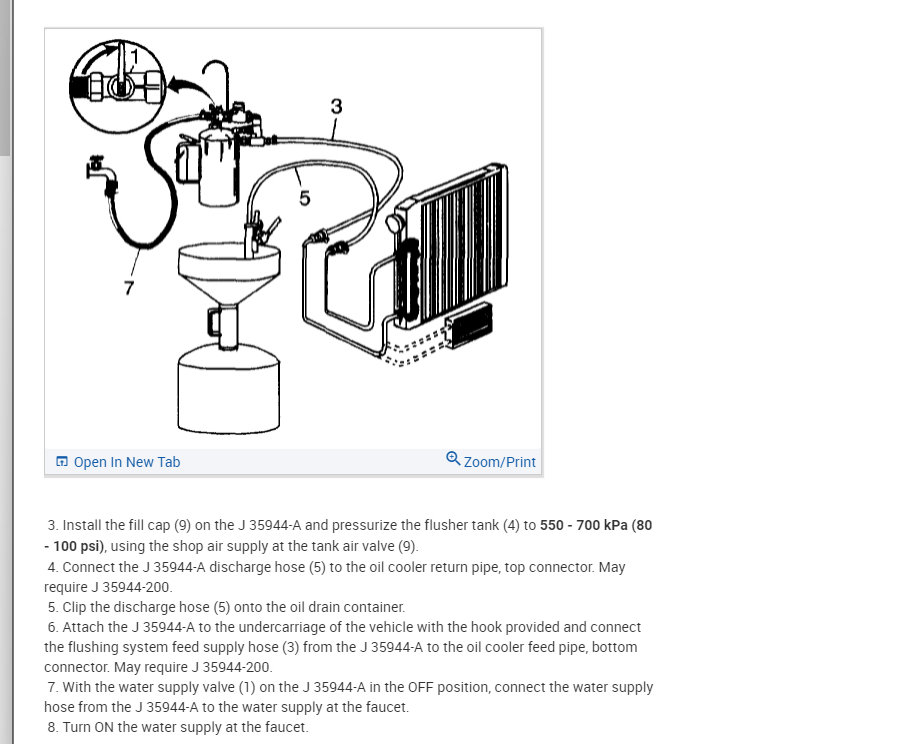

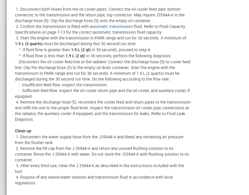

i need to know what line goes to what fitting on trans and cooler. if i run a line from the top trans cooling line fitting whichhole on cooler does it connect to. which way does fluid run through system i think i may have them connected wrong running fluid out when should be ran in
