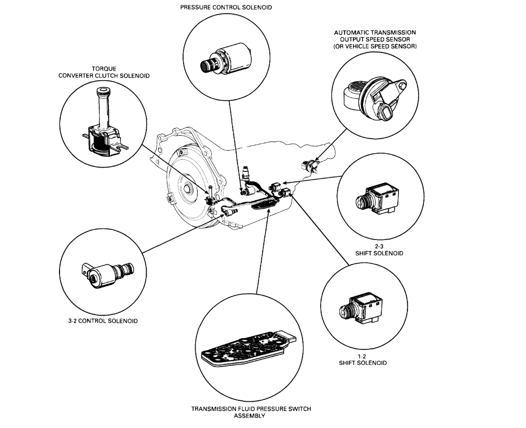

How do you tell which is the a solenoid and which is b solenoid for the 1/2 and it's 3/4 solenoids?

Here is a guide that will help you remove the pan and a diagram below that shows the solenoid locations and identification:
Image (Click to enlarge)

The 3-2 solenoid! can it be reached without taking the pan off?

Does not look like it.
