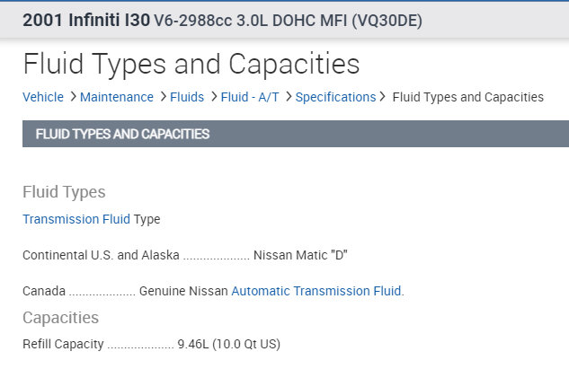

To answer your question, yes it could. This requires a specific Nissan-type fluid. See pic 1 below. If the wrong fluid is used, it can prevent the smooth operation of clutch packs and other components.
Additionally, low transmission fluid can also cause a slip along with low line pressure. Did this issue start after the replacement of the fluid?
See pic below.
