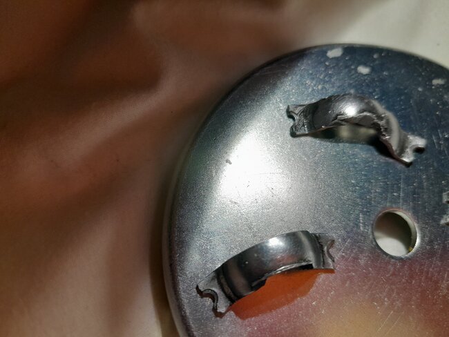

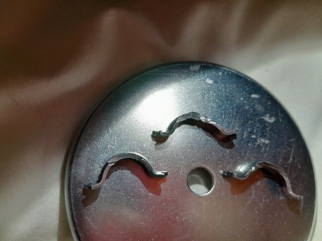

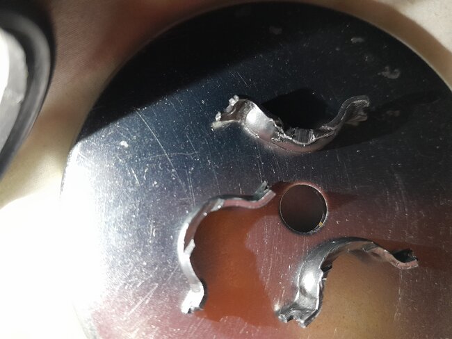

Can you please upload a picture of the piece you found?
Feb 25, 2023 at 1:04 PM
JAZZYJEAN
  • 7 POSTS
Hi, pics here are the pics.
Sorry about the other 2 pic other 2 pics they d
on't belong hopefully you can.
Enlarge these pics to see better detail.
Feb 27, 2023 at 10:57 AM
JAZZYJEAN
  • 7 POSTS
Hello, I was wondering if you had received the pics, I sent was waiting on your response there's 2 other pics that don't belong that was sent please disregard those but do let me know what your conclusion is on what I sent. Thank you
Feb 28, 2023 at 2:21 AM
Thanks for the images, so these came out of the oil drain hole for the transmission. They look like part of the shift shaft brackets or they could be part of a bearing retainer. I think you will need to have the transmission built.
