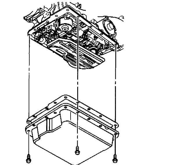

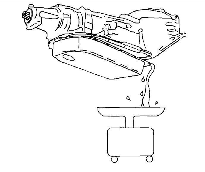

The first thing I would do is to drop the pan and check the filter and be sure it is not clogged with dirt or debris. If it is, that would be the reason for the issue.
Beyond that, It may be an internal failure not allowing it to engage in gear.
