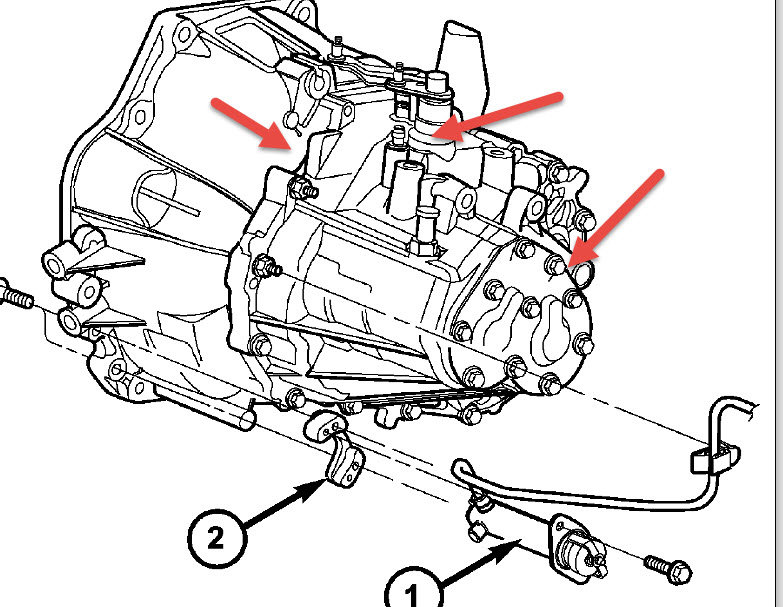

I just had my clutch replaced and now it's leaking transmission fluid. I assumed it was the output shaft seal and had that replaced as well. It's still leaking and now it appears to be coming from the top of the transmission.. Any ideas on where/what could be causing it?

three of the arrows in pic show where it could possibly be, could be from engine as well, clean it off and see where it is......

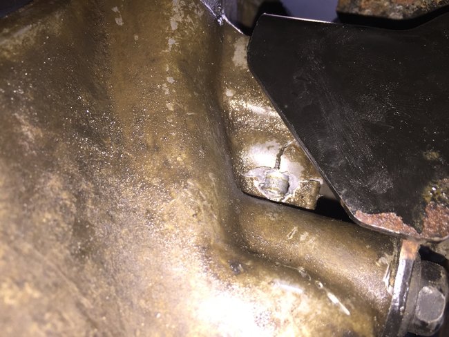

Found the leak... Never using a back yard mechanic again.. Any ideas?

you shold have pointed to it or an arrow to show where it's leaking. or if you can send a pic with pointing. if it 's by the black piece or what looks like a piece of metal by that try cleaning with choke cleaner or brake clean with a small wire brush. then some jb weld for aluminum if it's a hole.
