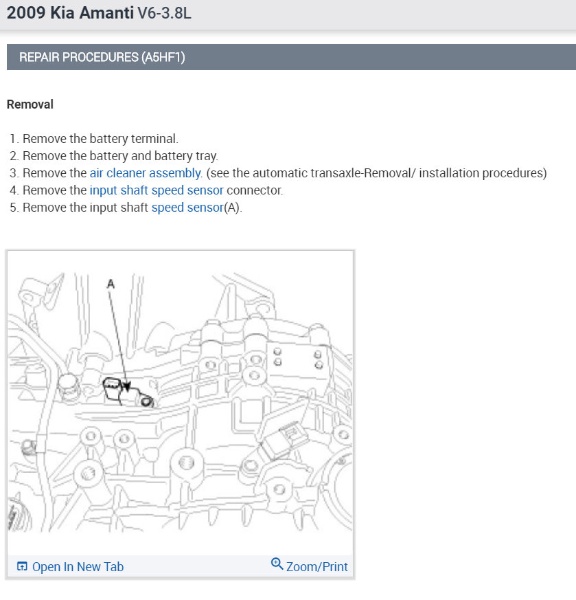

The code is the problem which is for the input shaft sensor for the transmission. here is the location so you can change it out. Check out the diagrams (below). Please let us know if you need anything else to get the problem fixed.

Hmm, that would be easy to change for sure, but why is it saying gear 2 incorrect ratio?
Sep 5, 2019 at 3:16 PM
Because the sensor is not working correctly. We might need to raise the car up. here is a guide that will help:
