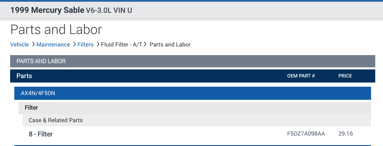

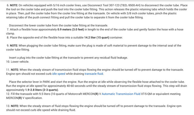

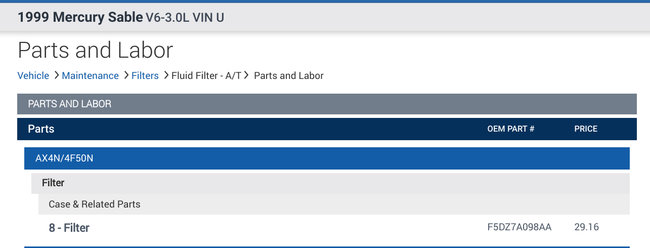

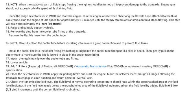

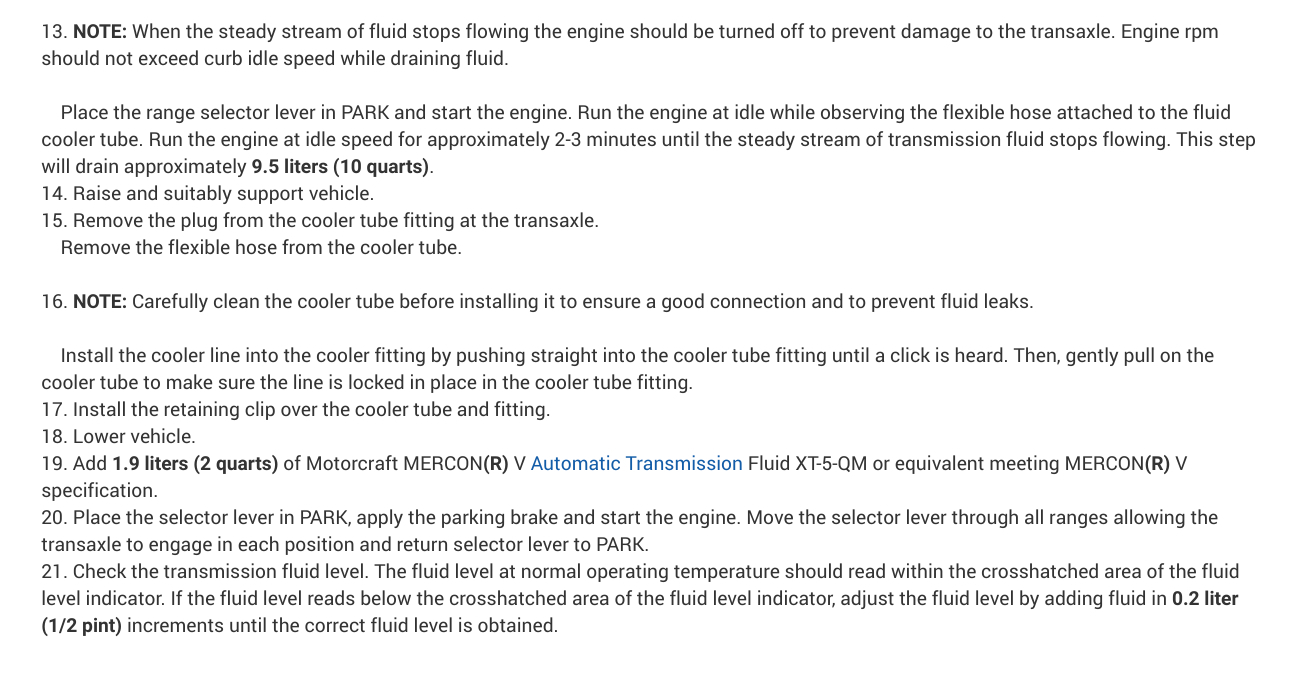

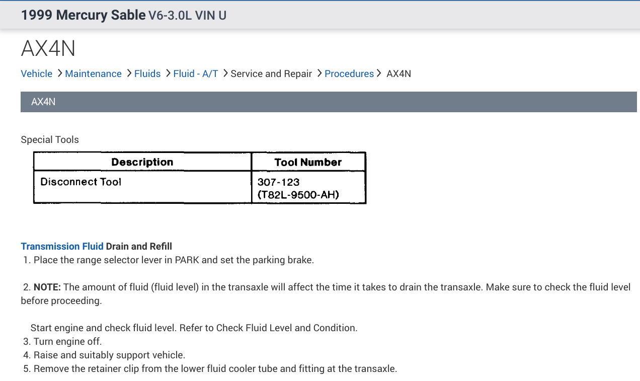

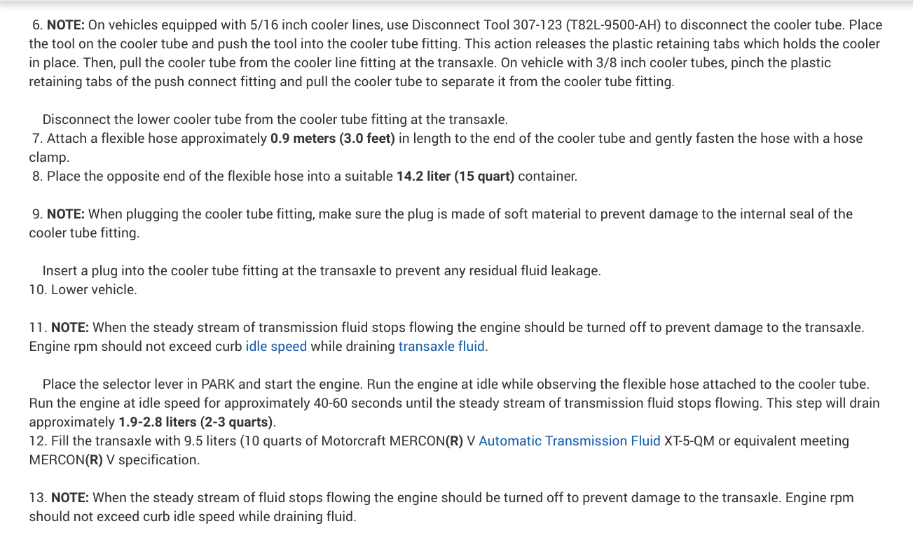

My estimate would be around $40.00 to $50.00. In the diagrams down below I have included the instructions for the draining and filling of the transmission fluid in your vehicle and the Original Equipment Manufacturer[OEM] part number for the transmission filter. Please get back to us with how everything turns out.
