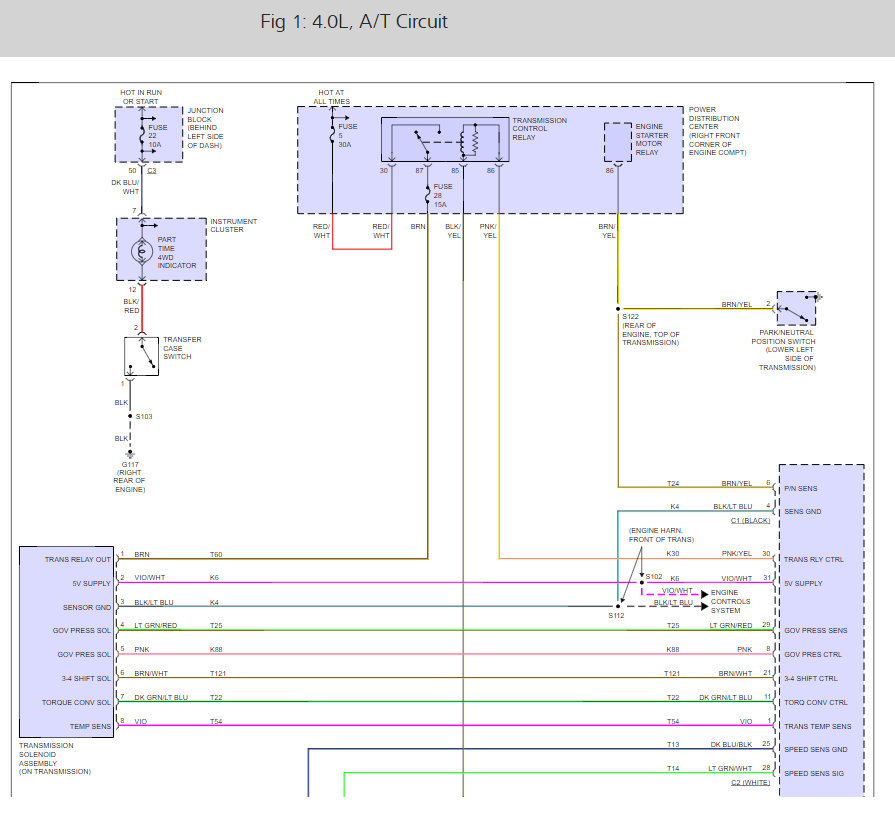

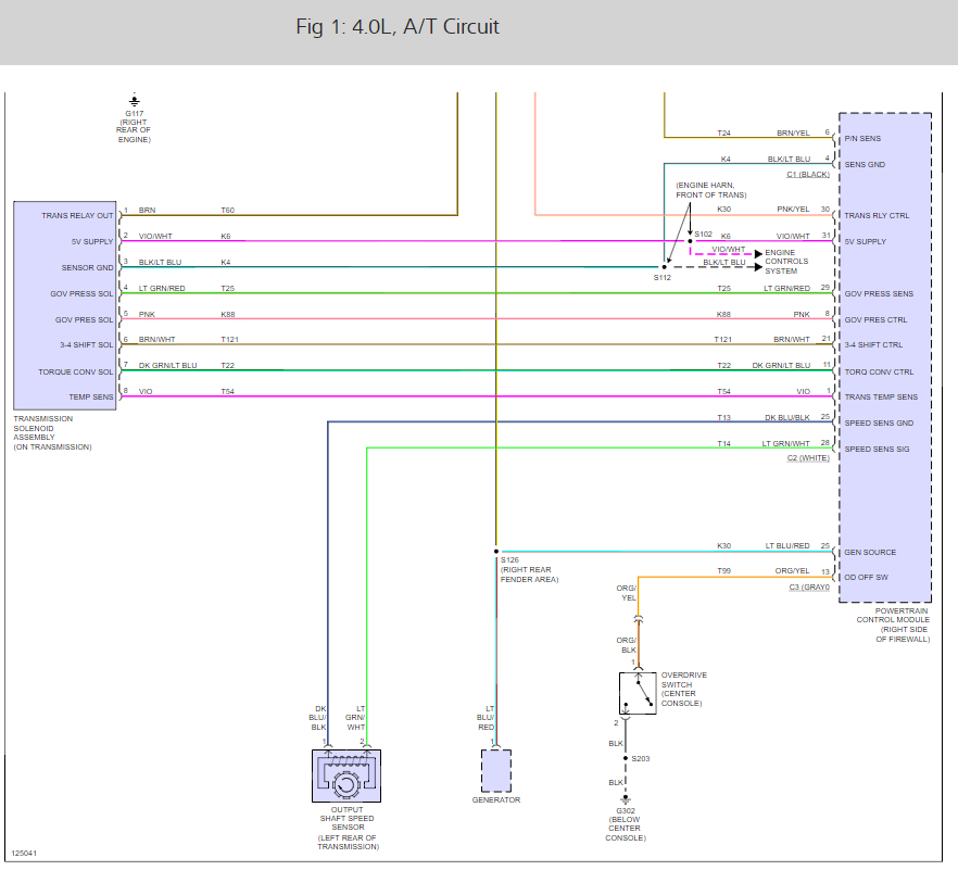

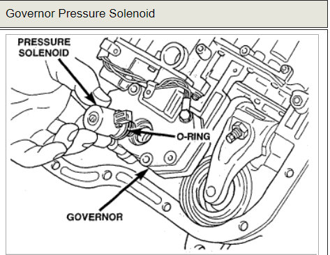

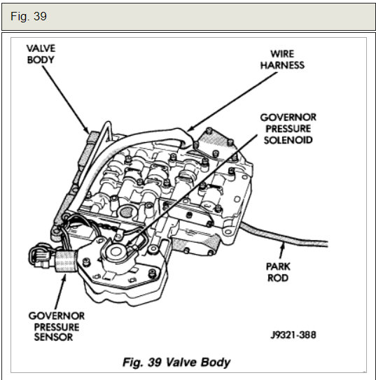

These transmission had a problem with the governor solenoid you must remove the pan which is sounds like it is leaking away here is a guide to help you see what you are in for when doing the job.
