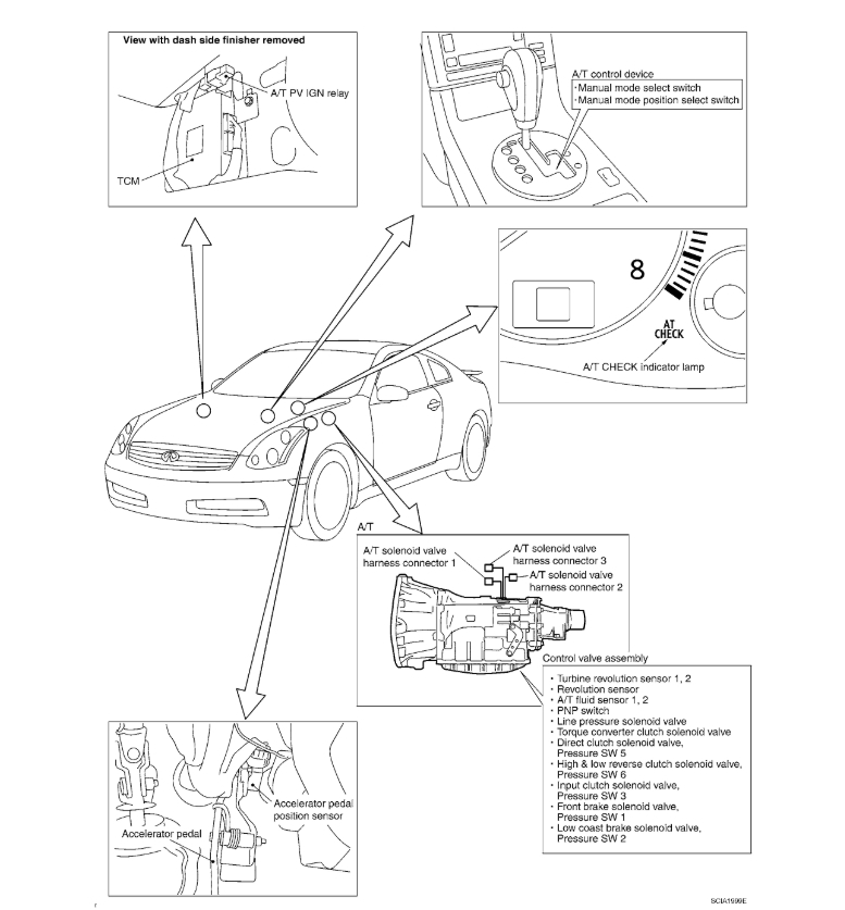

It sounds like you have a turbine shaft speed sensor that has gone out but to be sure lets run the codes
Here is the sensor location so you can check the wiring connector and replace the sensor if needed. Also how does the fluid look is it burnt? You will be able to smell it if so. Check out the diagrams (Below). Please let us know what you find. We are interested to see what it is.
