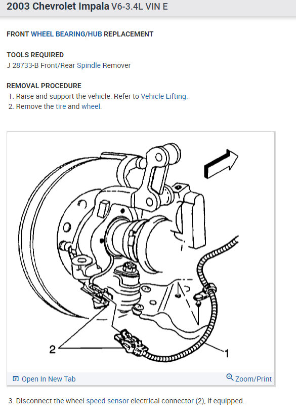

Was the traction light illuminated before the replacement of the hubs?

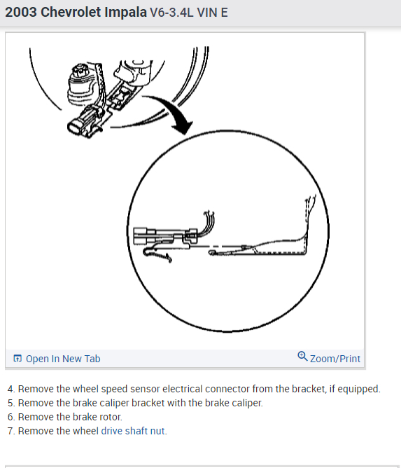

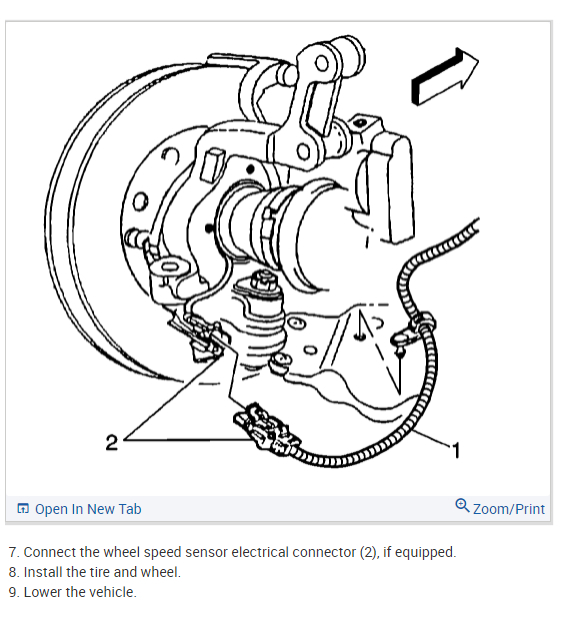

There is ABS sensor that goes to each hub. If they are faulty it will trigger the ABS and the traction control light.
Make sure that the sensors are plugged in properly. Check for any corrosion in the wiring on the vehicle side.
The traction control is a part of the anti skid system and it does not have a separate fuse.
You can also get the vehicle scanned for trouble codes within the ABS traction control system. That can point to the issue. As it could be a bad sensor.

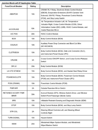

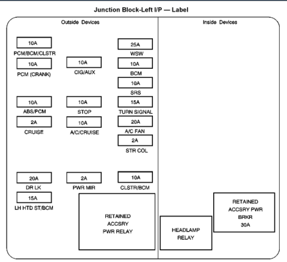

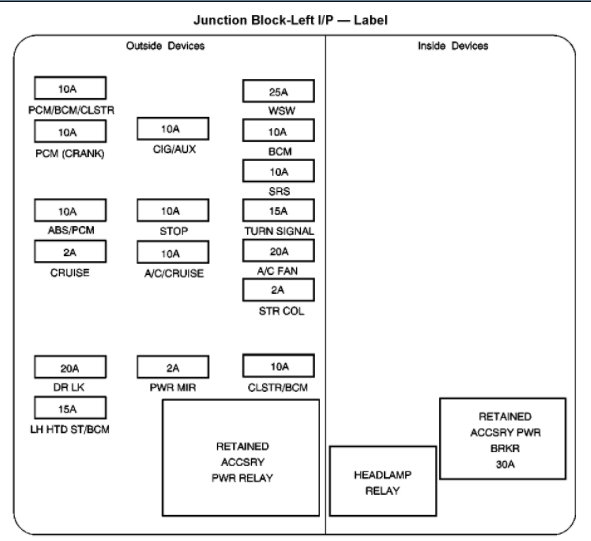

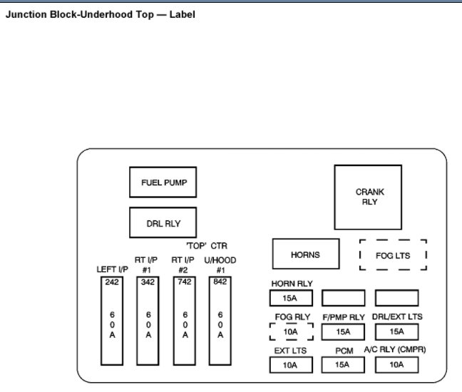

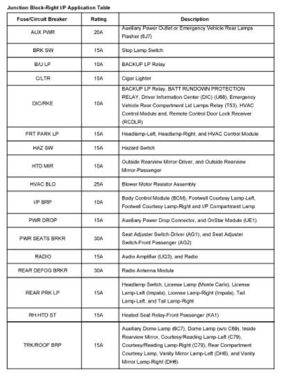

Hello, I'm Danny.
Here is the information you requested. Here are a few tutorials for you on how to test and replace fuses:
https://www.2carpros.com/articles/how-a-car-fuse-works

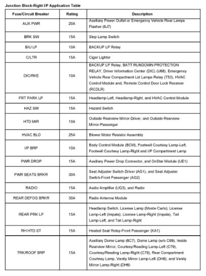

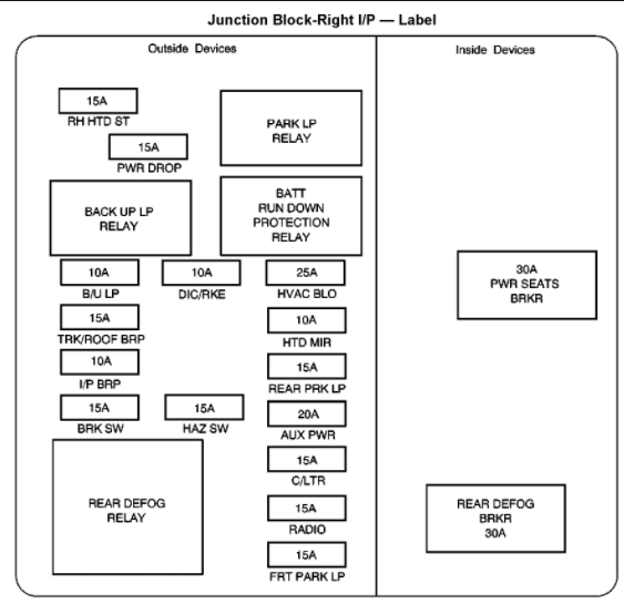

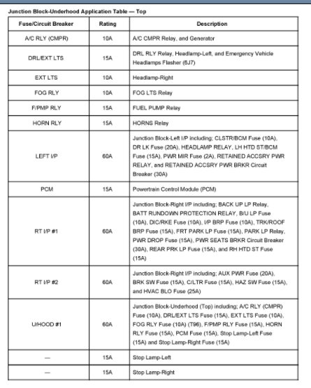

I've attached pictures below showing the fuse legends and locations on your Impala. Hope this helps and thanks for using 2CarPros.
