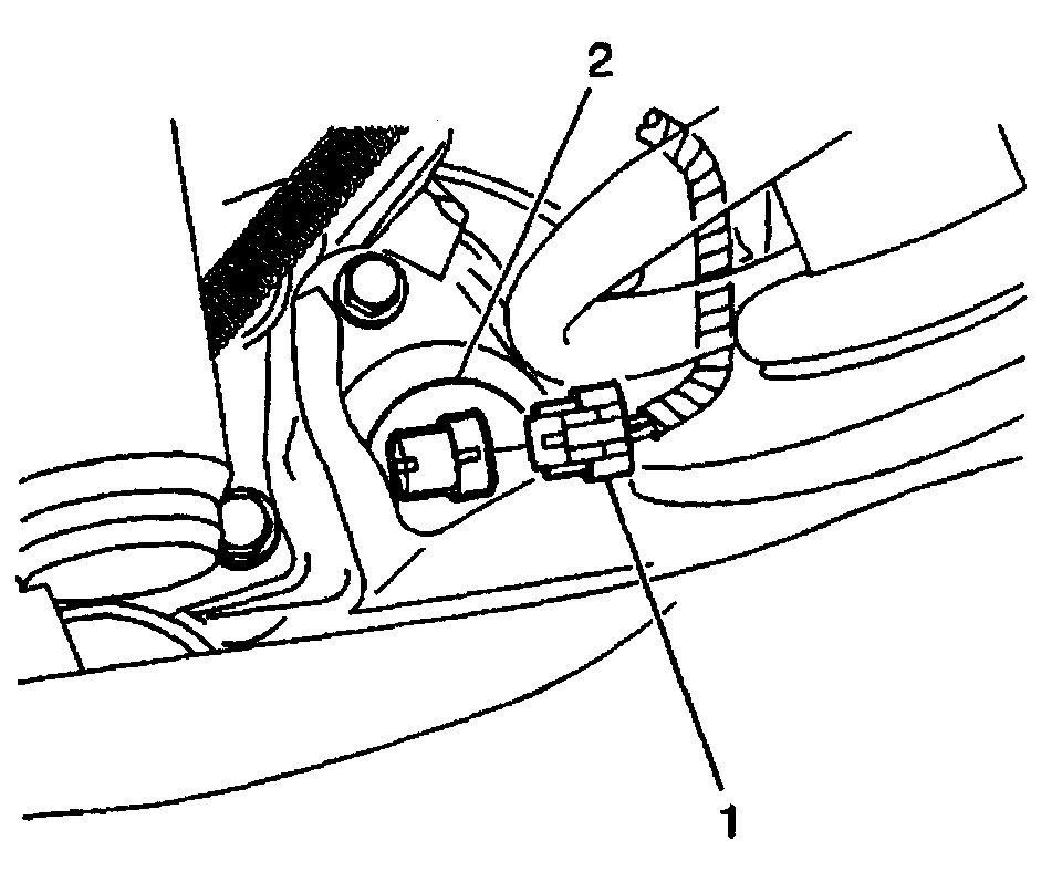

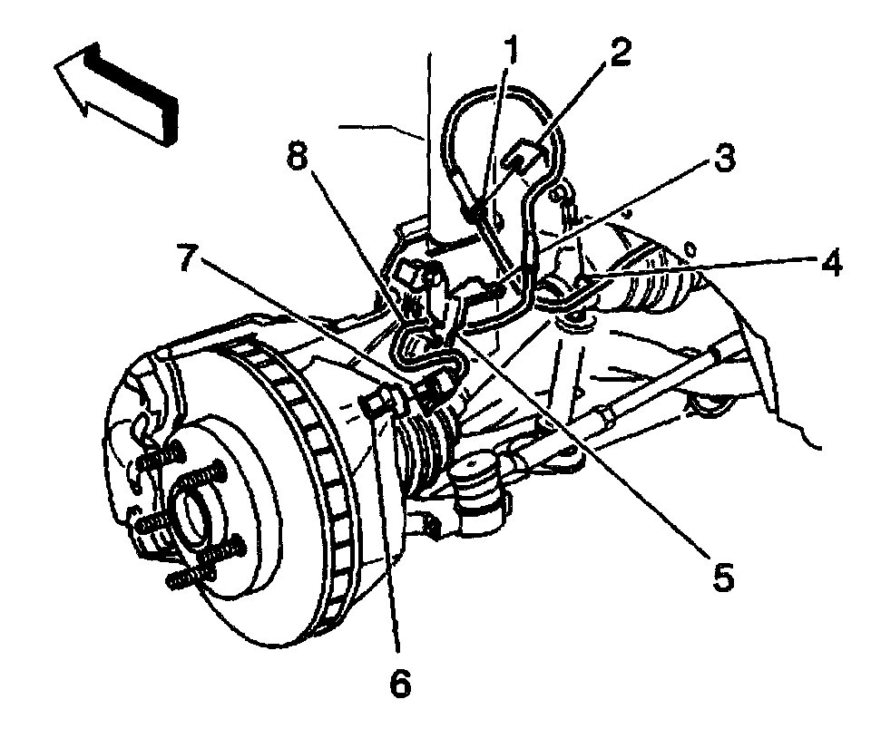

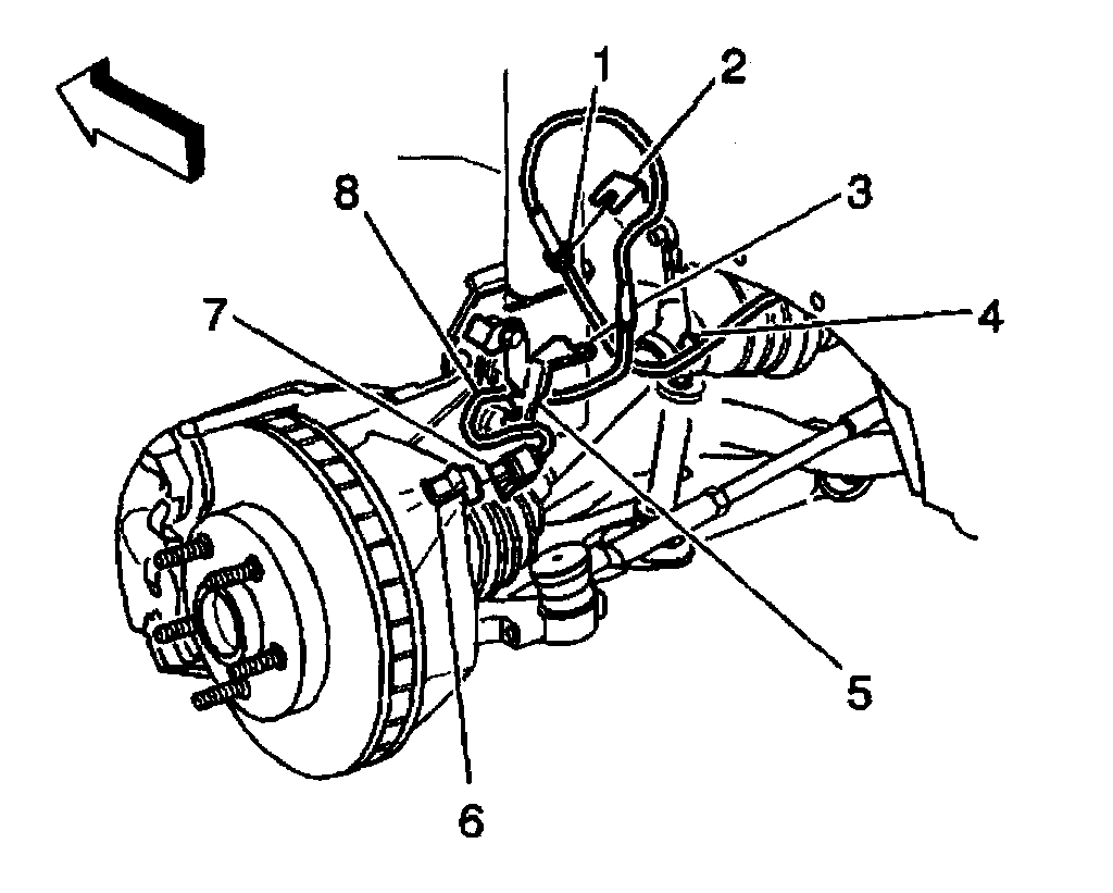

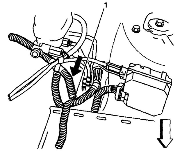

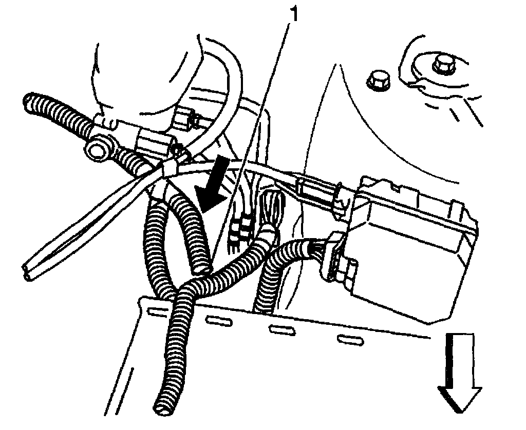

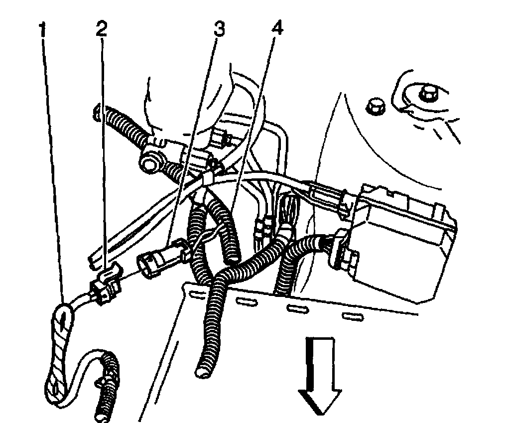

If you look at the pics below, pic 1 shows the location of front wheel sensors and pic 2 is of the rear.

Removal Procedure
Important: The wheel speed sensor wiring is included in the engine harness. The wiring between the wheel speed sensor and the heat shrink sealed splices is high-flex cable and must not be repaired or spliced. This procedure replaces the high-flex cable with a jumper harness from a supplied repair kit.

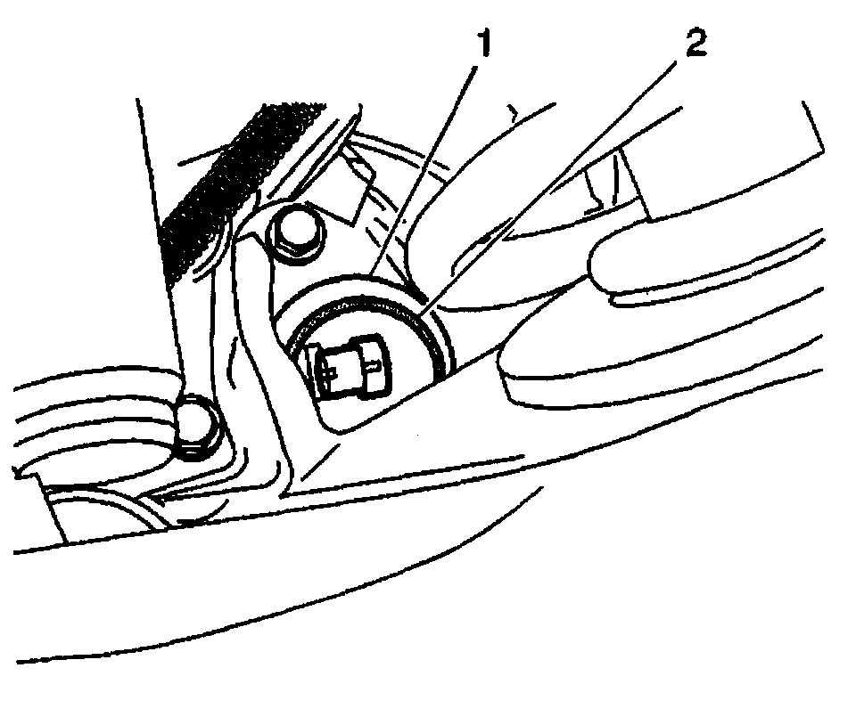

pic 3
1. Turn OFF the ignition.
2. Raise the vehicle. Refer to Vehicle Lifting.
3. Remove the left front wheel.
4. Remove the wheel speed sensor connector (7) from the wheel speed sensor (6).
5. Remove the harness grommet (3) from the strut bracket (5).
6. Remove the harness grommet (1) from the rail bracket (2).
7. Remove the harness clip (4) from the rail bracket (2).
8. Route the wheel speed sensor wiring (8) through the top of the engine compartment.
9. Lower the vehicle. Refer to Vehicle Lifting.

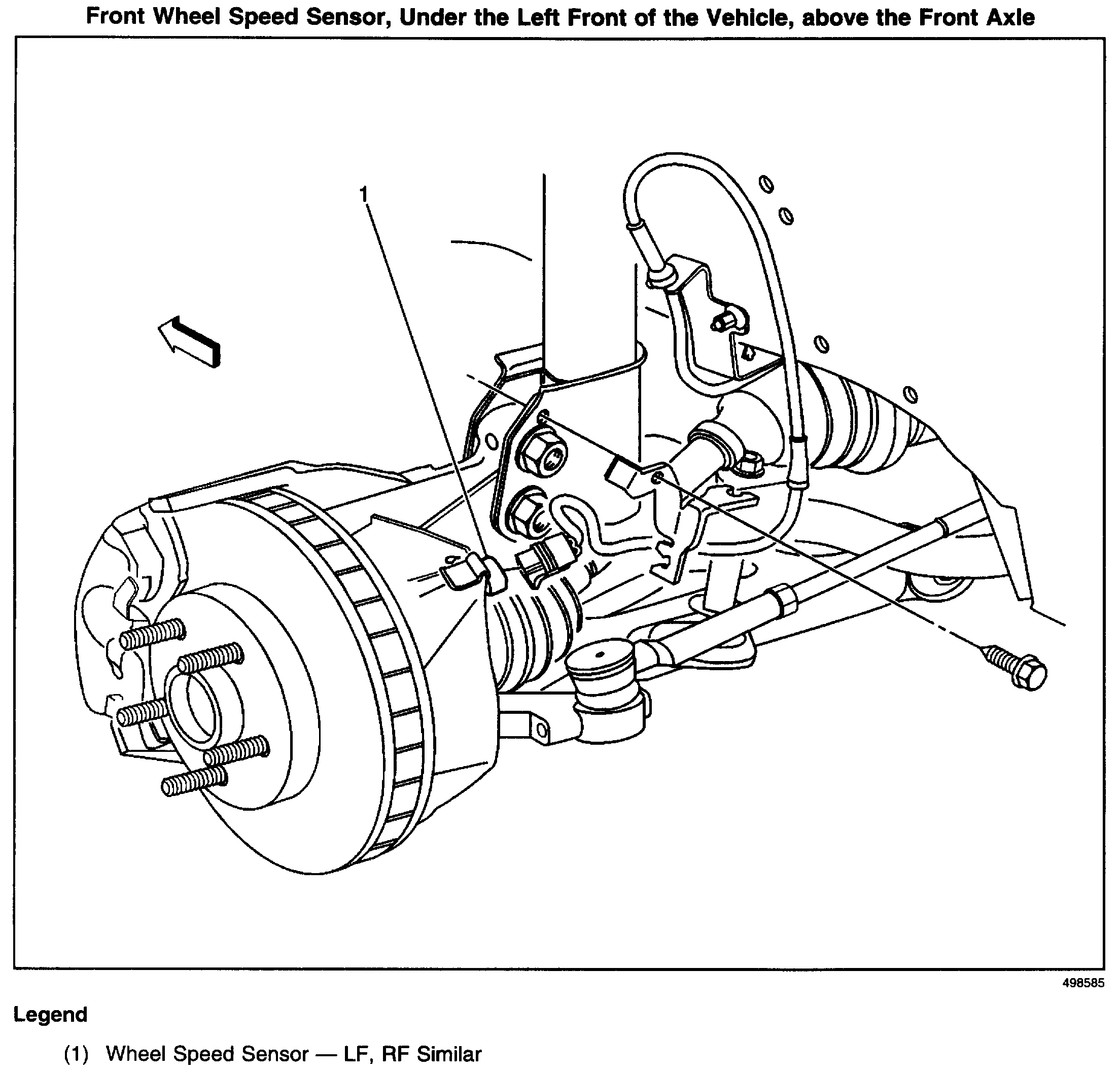

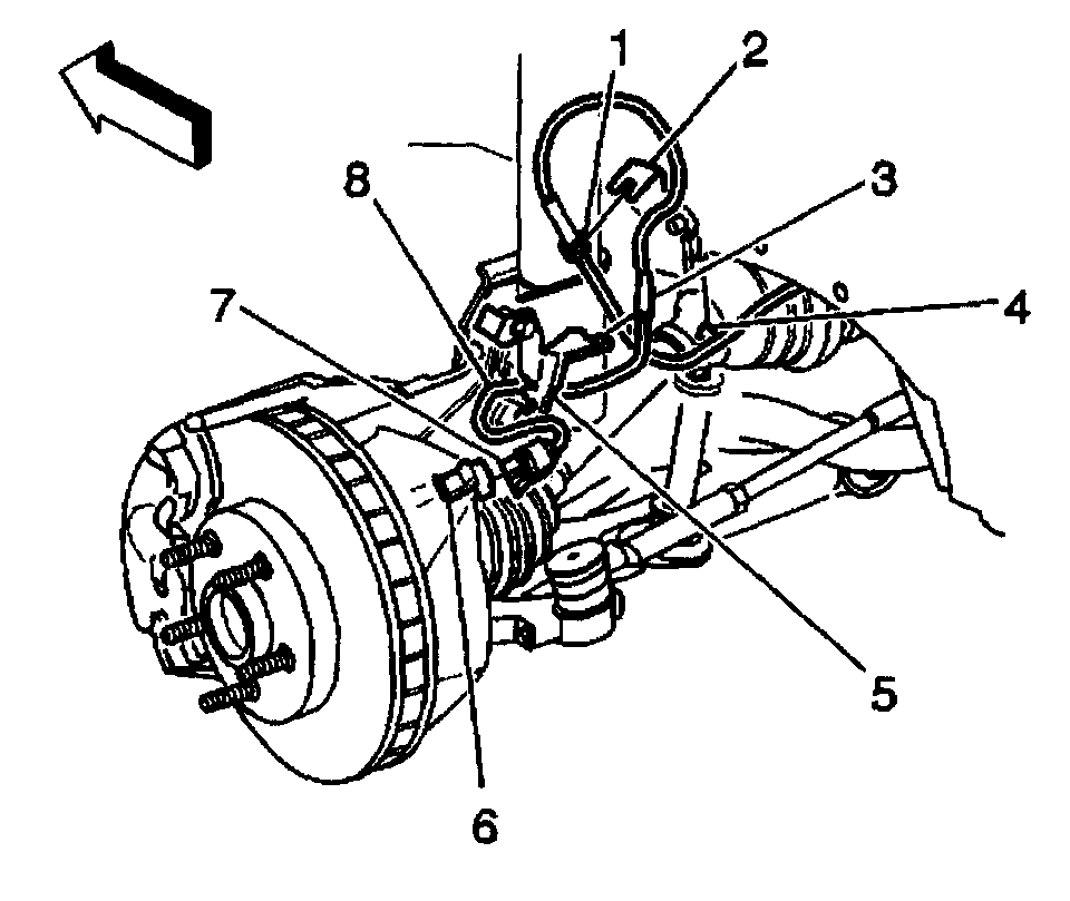

pic 4
10. Remove the air cleaner.
11. Cut the engine harness conduit (1) to locate the 2 heat shrink sealed splices.

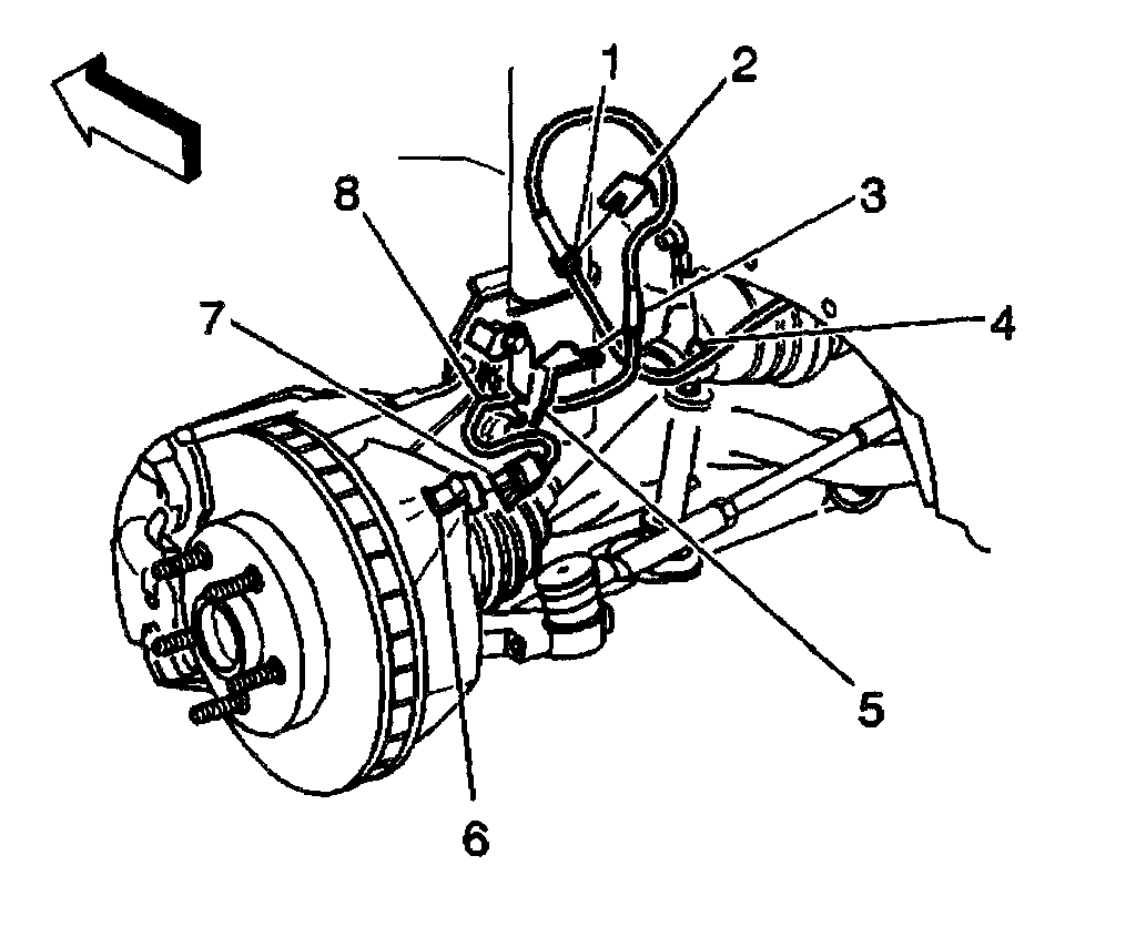

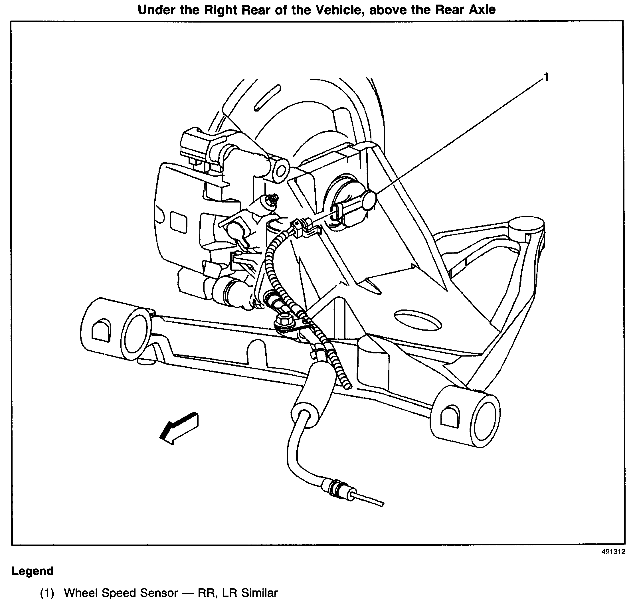

pic 5
1. Replace the wheel speed sensor jumper harness.
2. Route the wheel speed sensor jumper (1) through the engine compartment to the wheel well.
3. Install the air cleaner.

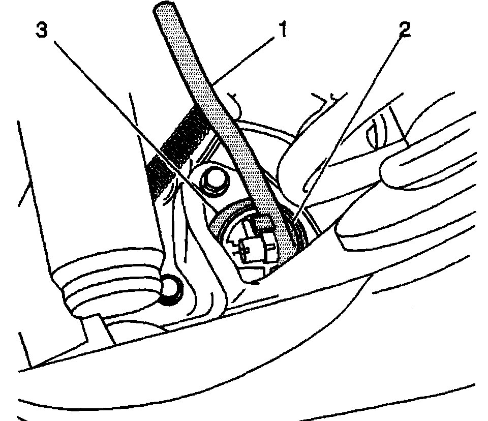

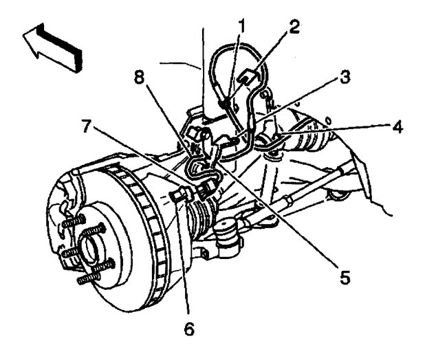

pic 6
4. Raise the vehicle. Refer to Vehicle Lifting.
5. Install the wheel speed sensor connector (7) to the wheel speed sensor (6).
6. Install the harness grommet (3) to the strut bracket (5).
7. Install the harness grommet (1) to the rail bracket (2).
8. Install the harness clip (4) the rail bracket (2).
9. Install the left front wheel.
10. Lower the vehicle. Refer to Vehicle Lifting.
11. Perform the ABS Diagnostic System Check.

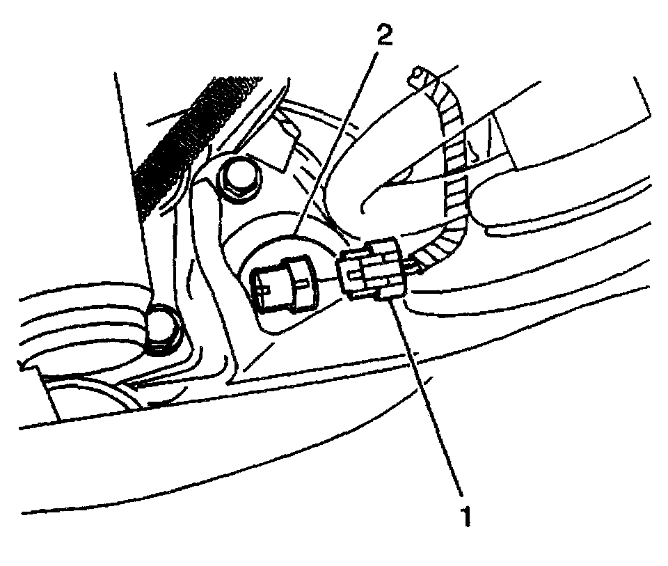

Removal Procedure
pic 9
3. Remove the rear wheel.
4. Remove the wheel speed sensor connector (1) from the wheel speed sensor (2).
Important: Do not reuse the wheel speed sensor after it has been removed.
5. Remove and discard the wheel speed sensor (2).
