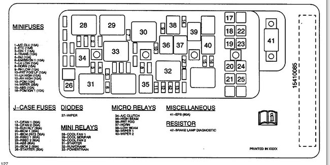

Hello, thanks for using 2CarPros.com. Is the check engine light on as well? There are some important checks to do before replacing the ECM, they can be very costly and if it does not repair the issue, you are going to be out a lot of money. The first thing is, if you are unable to communicate with the ECM, then the ECM is mostly likely not being powered up or has lost one of its ground wires. The car does have high mileage and wires do corrode over time. Check all the fuses to begin with, there are fuses under the dash down on the left side near the pedal area and there is a fuse box under the hood. This is a diagram of the fuse panel under the hood. The panel covers will have labels telling which fuse is which. This could also be an issue with the BCM (body control module). So before replacing costly modules or computers, someone should really test wires to make sure everything is powered up correctly and there are no other problems going on. But the communication issue should be addressed first. It may be the heart of the problem.
