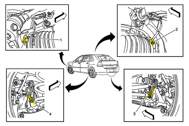

If you look below, I attached a pic showing sensor locations. Simply inspect them for damage and make sure they are tight.
