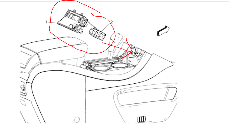

Also, you have a switch to manually turn off the traction control. If you turn it off, does anything happen? See pic below for the location.
See pic below.
