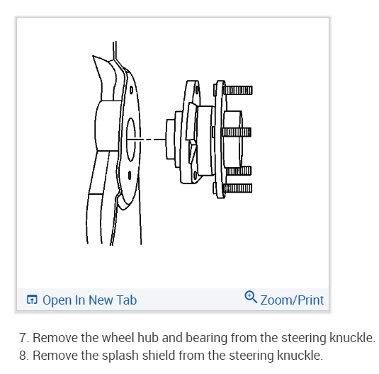

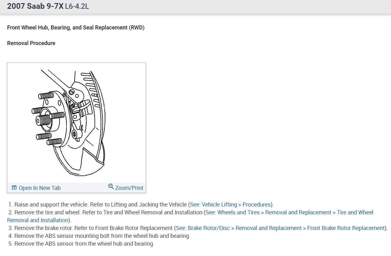

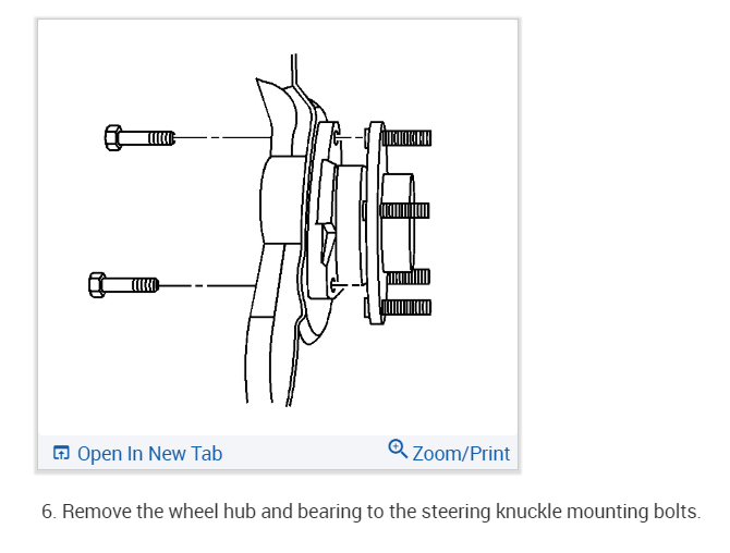

It sounds like you have a wheel bearing hub that is going out which will cause the sensor to stop working. Here is a video to show you how to scan the ABS to confirm the issue and how to replace the hub step by step and diagrams below to how you how to fix it in your car:
https://youtu.be/rTtAnsOlZU4
and
https://www.2carpros.com/articles/bearing-hub-replacement
Check out the diagrams (below). Please let us know what you find.
