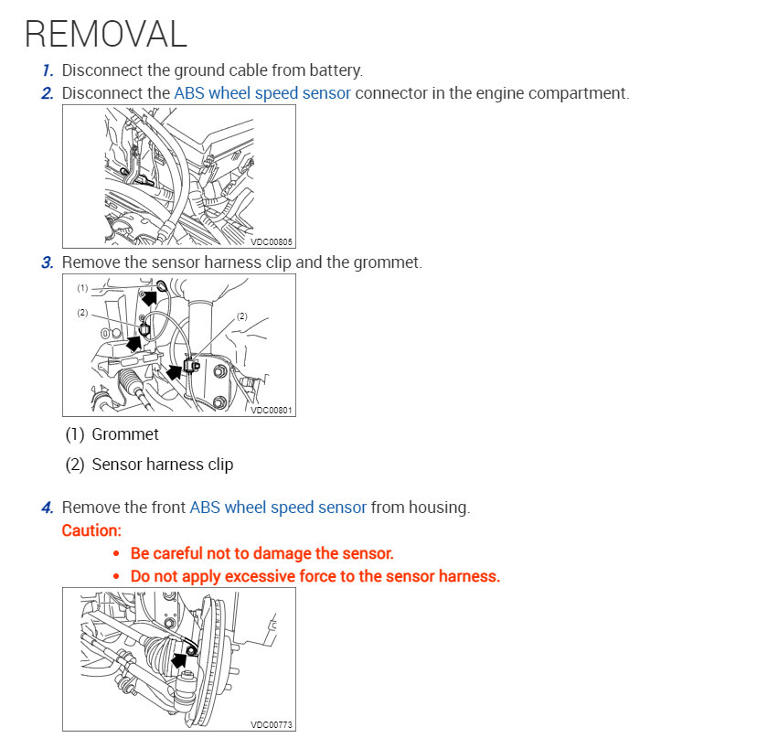

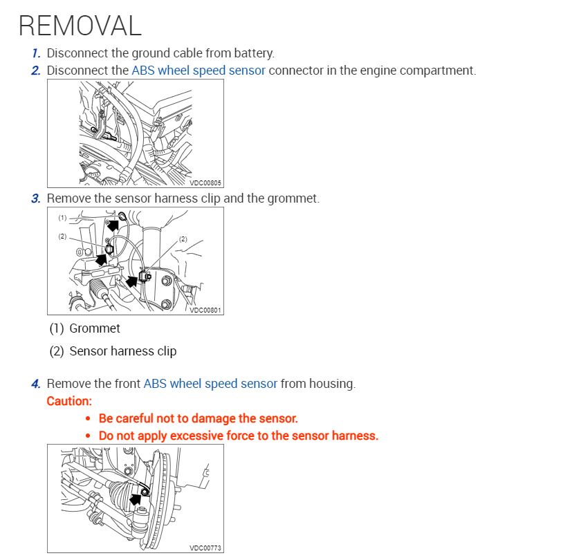

These lights flash when there is a problem with the ABS and traction control, we should run the codes to see what comes up, this guide can help. Also check the brake fluid level.
https://youtu.be/rTtAnsOlZU4
and
https://www.2carpros.com/articles/anti-lock-system-testing-and-repair-abs

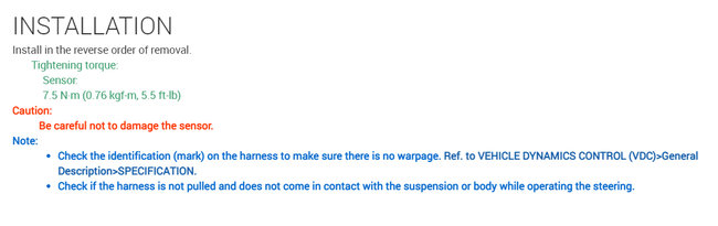

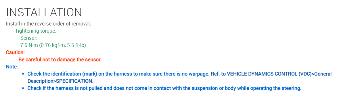

Usually, it will be a wheel speed sensor is not working, here is how you can replace the front sensor which you can see is not very hard. Let me know which code comes up. You can get a scanner from Amazon for about $20.00. Check out the diagrams (below). Please let us know what happens.
