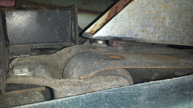

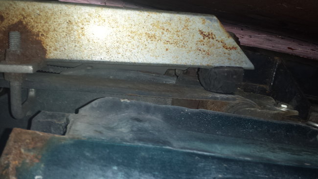

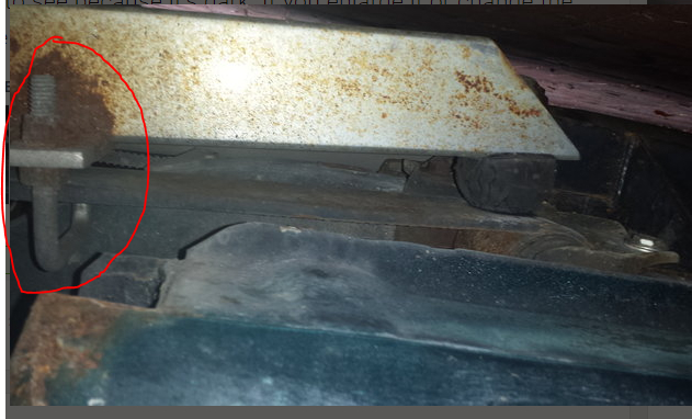

I attempted to upload 2 pictures the first time I asked the question I selected them but the upload didn't seem to do anything. I will try again. But the bottom line is this: The snubber on the passenger side is completely gone so the traction bar is tight against the lesf spring and I don't know how to separate the traction bar from the spring to install the new snubber which is like 1 3/4" high. On the drivers side there's a snubber there but it is smashed, again how do you separate the traction bar from the spring? People talk about adjusting them by cutting off a 1/4" like they are easily accessible.
The pictures uploaded upside down not sure why. The snubber on the driver's side is hard to see because it's dark. If you enlarge it or change the gamma you can see it better. 1st one is passenger's side.

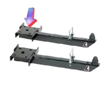

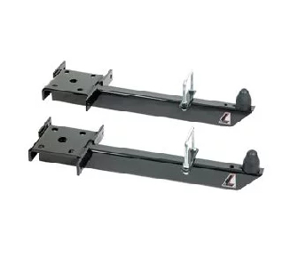

To remove the traction bar it's held to the rear differential with 2 u-bolts on the bottom of the spring as well as the catch you included in your picture. The most popular brand traction bars for a Camaro were called "Lakewood" I can think of 2 places you might be able to find the snubbers. See photos attached below. JEGS and Summit Racing and you can find both companies online.Hope this helps and thanks again for using 2CarPros.

The four bolts that hold it to the differential? Check out the picture below.
