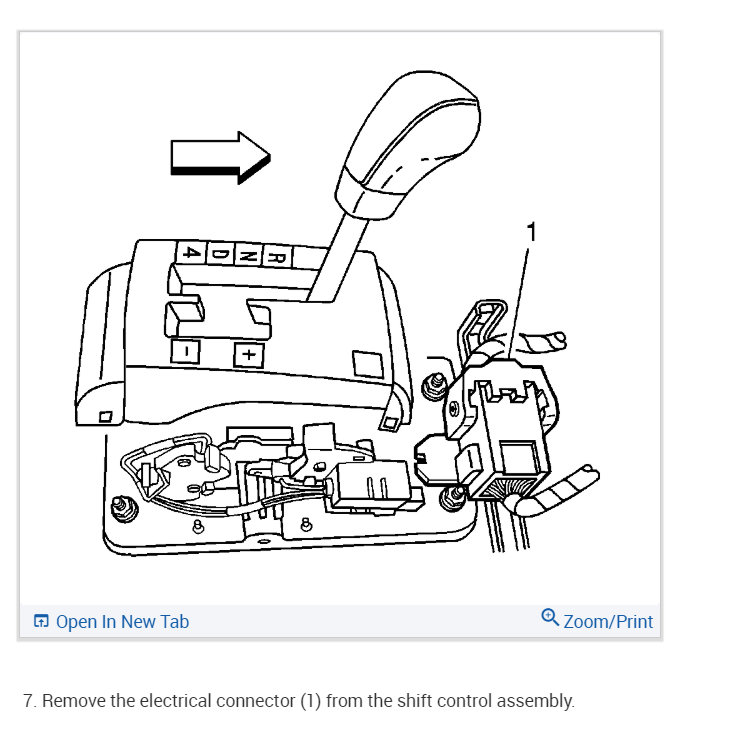

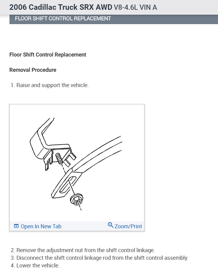

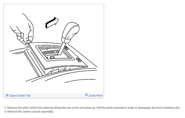

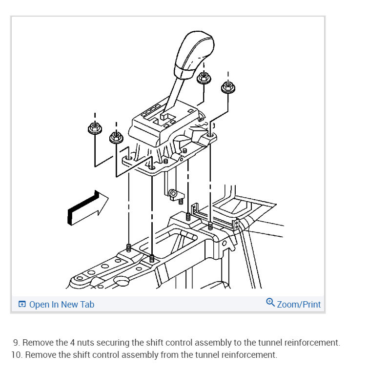

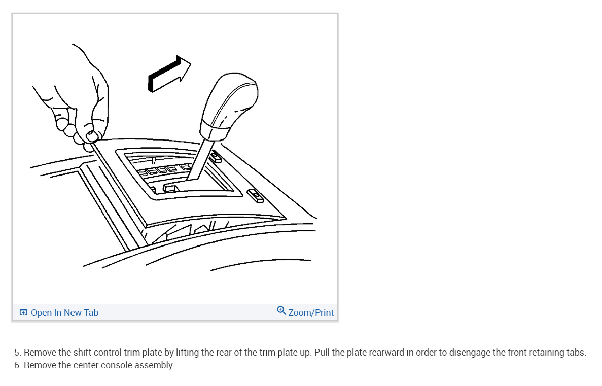

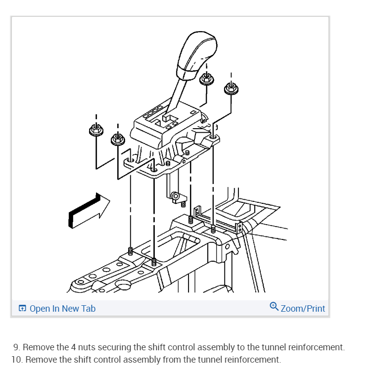

When you say the engine will not start, do you mean the engine not crank over (starter) or the engine cranks but does not run? Can you please shoot a quick video with your phone so we can see what's going on? that would be great. You can upload it here with your response. If the engine will not crank over these cars had a problem with the shift linkage which will cause both issues. Check out the diagrams (below). Please let us know what you find. We are interested to see what it is.

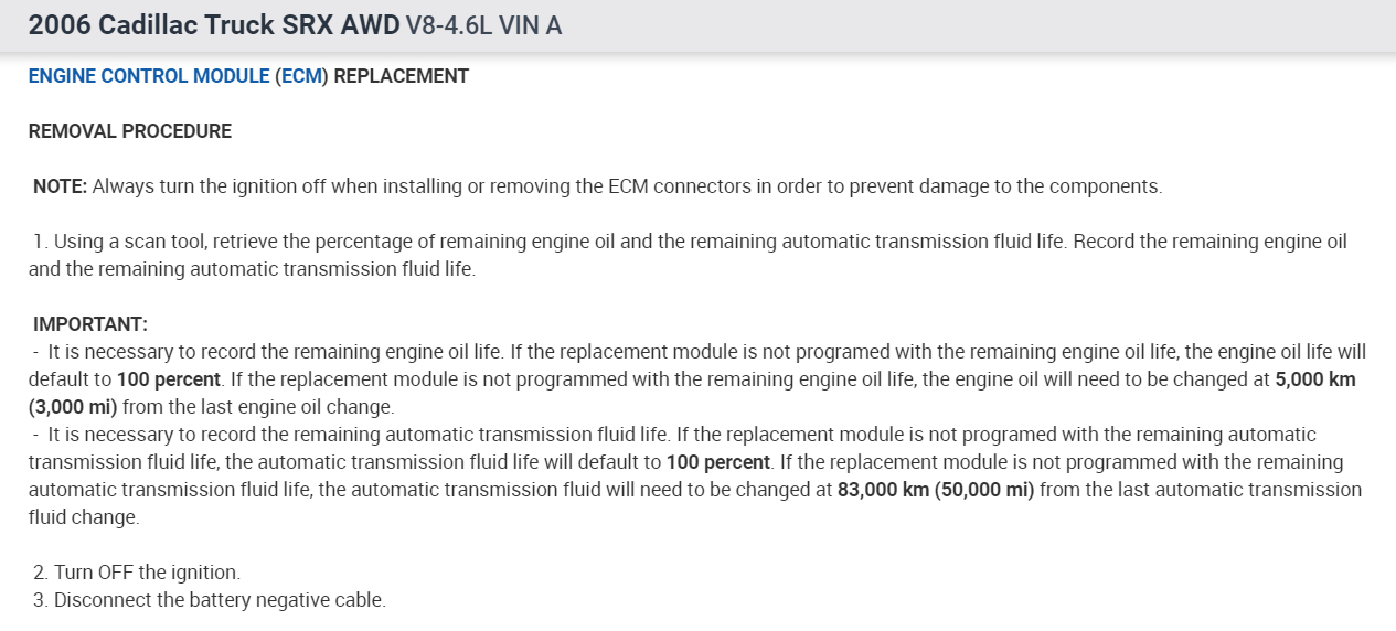

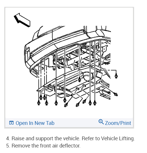

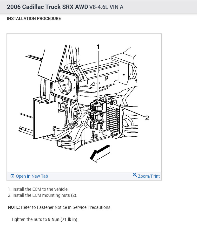

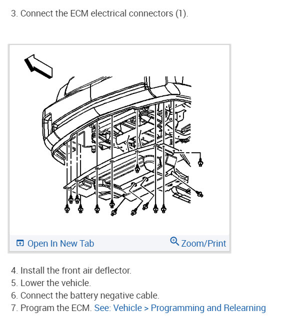

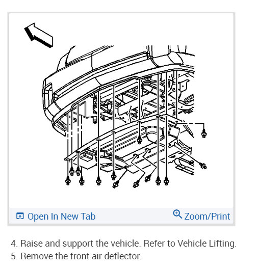

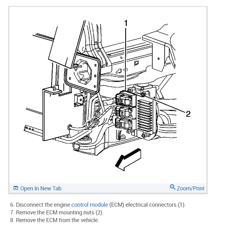

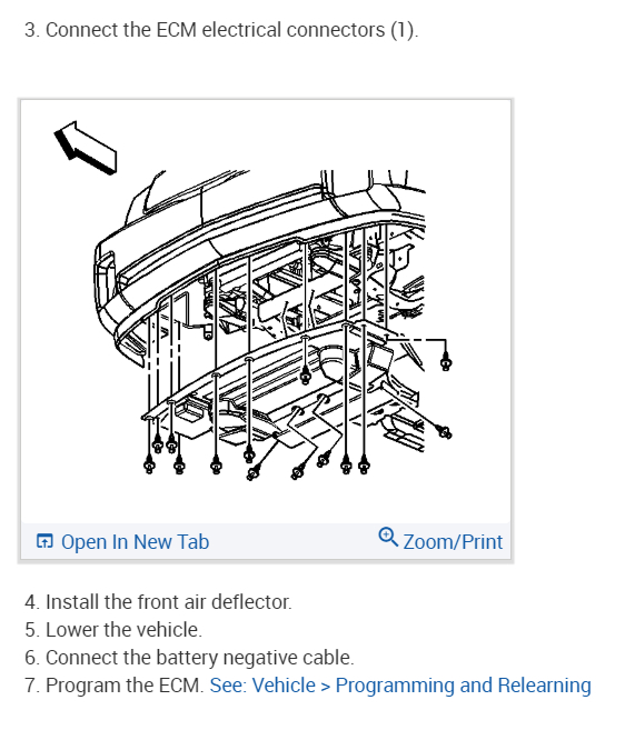

Sounds good, here are the instruction on how to replace the ECM in the diagrams below:
ENGINE CONTROL MODULE PROGRAMMING AND SETUP
The following service procedures require either a programming or a setup event performed for a complete repair.
ECM Replacement
If the engine control module (ECM) is replaced, the following procedures must be performed:
1. The ECM Reprogramming-Refer to Service Programming System (SPS).
2. The CKP System Variation Learn-Refer to CKP System Variation Learn Procedure.
3. Engine Oil Life Remaining-When available, use a scan tool to reset the Engine Oil Life Remaining back to the original percentage recorded before the module was replaced.
4. Transmission Fluid Life Remaining-When available, use the scan tool to reset the Transmission Fluid Life Remaining back to the original percentage recorded before the module was replaced.
5. Theft Deterrent-Refer to Programming Theft Deterrent System Components.
ECM Reprogramming
- If the ECM needs to be reprogrammed, refer to Service Programming System (SPS).
- Engine Oil Life Remaining-When available, use a scan tool to reset the Engine Oil Life Remaining back to the original percentage recorded before the module was reprogrammed.
- Transmission Fluid Life Remaining-When available, use the scan tool to reset the Transmission Fluid Life Remaining back to the original percentage recorded before the module was replaced.
Setup for Component Replacement
The replacement of some components will require a setup procedure for complete repair.
If any of the following components are replaced, a CKP System Variation Learn Procedure must be performed.
- Engine replacement
- Any engine repair that disturbs the crankshaft position (CKP) sensor or its relationship with the crankshaft reluctor wheel
- CKP sensor

Are those diagrams for a 2006 Cadillac SRX?
Jun 20, 2020 at 3:29 PM
Yes, look at the top of the first diagrams depicts the car. Let me know what happens please.

That diagram reads that it is for a 2006 V8. I have the V6 3.6L. Will that make a difference on ECM location?
Jun 22, 2020 at 10:58 AM
Nope, should be the same place and the same procedure.
Jun 23, 2020 at 11:45 AM

What is the unit that is on the upper left side of the engine that has two wire harnesses plugged into it?
Jun 23, 2020 at 1:32 PM
