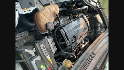

Just made it home from a weekend trip and my car started giving me problems. It idles rough, sometimes surging to 3,000 RPMs after putting it in park. The trac light also comes on while idling. The OBD shows codes P0128, P0171, P0324, and P2076. It was running fine before the trip.

I don’t have access to a live scan tool. However, I cleared the codes, and it came back with P0171, P0700, and P2076. Unfortunately, I don’t have a temperature gauge on my display. I will get my brother to check for vacuum leaks.

My brother said he found a leak at the PCV valve.
Jul 7, 2022 at 5:29 PM
Great. Repair the leak, clear the codes, and see what returns (if anything).
Let me know what you find or if I can help. This leak explains at least part of the codes.
