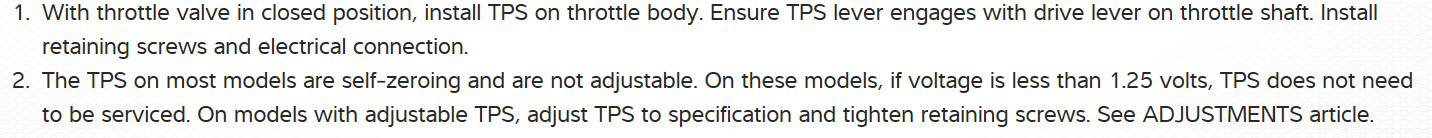

do i need to adjust the new TPS screws on my car or just install the new TPS? i read that some need to be adjusted.

I think it is a straight shot of disconnecting electrical and undoing screws. i am sending instructions while you are doing this clean throttle plate on both sides and IAC hole with choke cleaner.

Thank you HMAC300 for your help. The throttle and iac were cleaned and the tps installed .. she has more power and running great!
