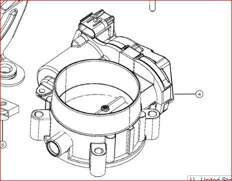

Hi Pheniox,
Unfortunately you need to change the entire throttle body. The sensor is part of the assembly.

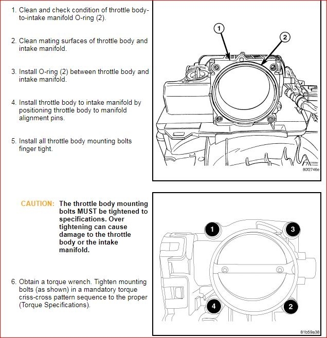

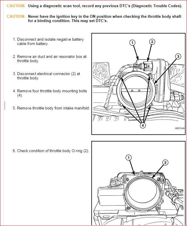

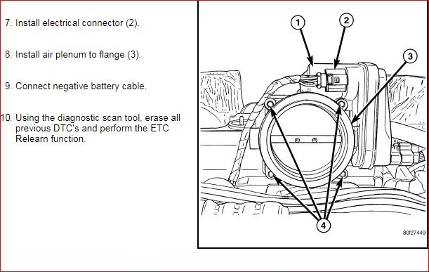

I attached the process for removing it and installing it. Also, a screen shot of the part itself that shows the TPS on the side of the throttle body.
Let me know if you need more information. Thanks
