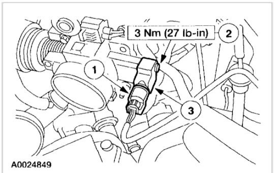

This vehicle originally had a p0174 fixed that condition then dtc p0153 reared its head, so I changed bank 1 sensor 1 and bank 2 sensor 2 upstream sensors. I have an abslt TPS % of 18.4-19.2 at idle and I believe it should be zero at idle .so I'm thinking this TPS is toast or on it's way out.I also get high short term fuel trims at idle and when disengaging throttle while in motion I smoke tested and no vacuum leaks. my Chilton manual says it can be replaced without re-calibration. And will relearn after the battery was disconnected and some say it has to have a pro scan tool to get the voltage set from 0-5 volts set for the throttle plate open and close setting. I have an actron cp9690 scan tool. Could this TPS and the high fuel trims at idle and while disengaging throttle and the p1151 all be related? What's the procedure for changing the TPS on this vehicle listed above xlt?
