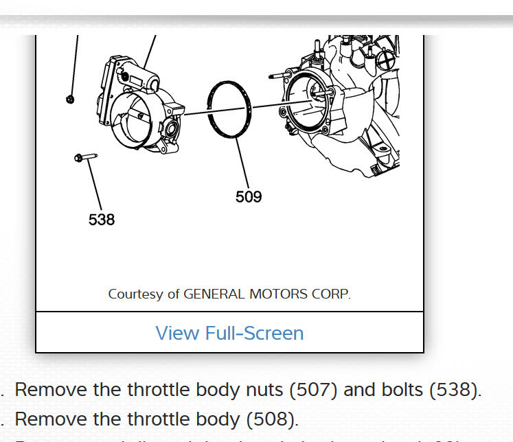

where is the TPS and how to change it? Thank you

It is all part of throttle body assembly so whole assembly needs to be changed. remove air duct to throttle body and disconnect electrical. See picture for rest and reverse for install. make sure to use a new gasket.
