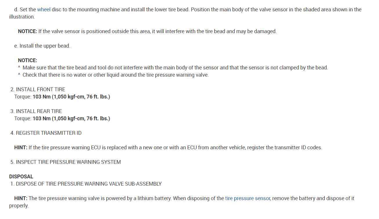

Hello, I installed a brand new OEM Toyota TPMS sensor in all of my tires. I am trying to program them so my light will turn off. What is a good TPMS scanner that can program OEM sensors. I bought the Autel maxitpms TS408 but it only programs MX sensors. Please provide me with any suggestions. The sensors are being detected but the light won't turn off.
