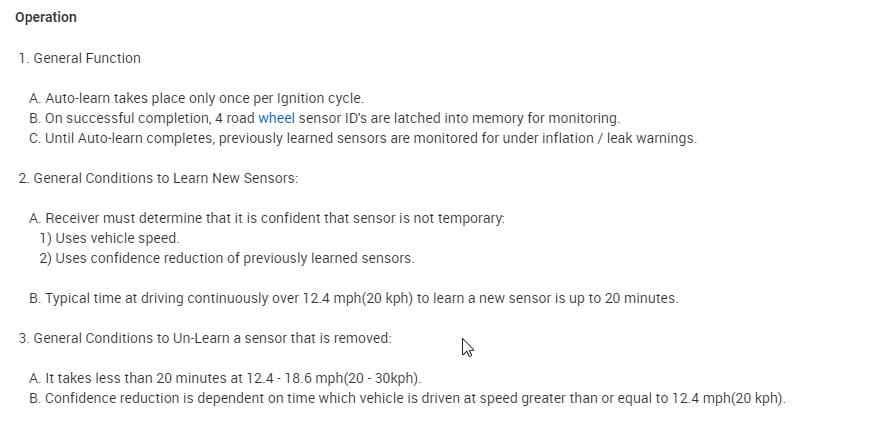

This system has an auto learn system. So it needs vehicle speed over 20 MPH for 20 minutes to learn new sensors. I attached the detail from the manual. Let me know if you have questions.
I am sure there is a way to manually enter the learn mode on the OEM scan tool but that detail is not in the service manual.
