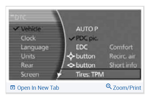

The TPM warning light was on. I've corrected the tire pressure and hit the reset selection for the TPM on the computer. It claims "TPM Resetting", and I drive it for a short ways, but rather than reset after a couple of miles, it sends a new "TPM Malfunction!" warning on the dash display as well as the onboard computer monitor.

1. Press the MENU button to open the start menu.
2. Move the controller toward "Settings".
3. Select "Vehicle" and press the controller.
4. Select "Tires: TPM" and press the controller

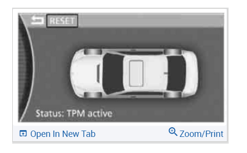

5. Start the engine, but do not begin to drive.
6. Select "RESET" and press the controller.
7. Select "YES" and press the controller.
8. Start to drive.
The tires are shown in gray and "Status:
Resetting TPM..." is displayed.
After a few minutes of driving, the newly corrected inflation pressures in the tires are adopted as the set-point values to be monitored. The resetting process is completed during driving. The tires are displayed in green on the Control Display.
