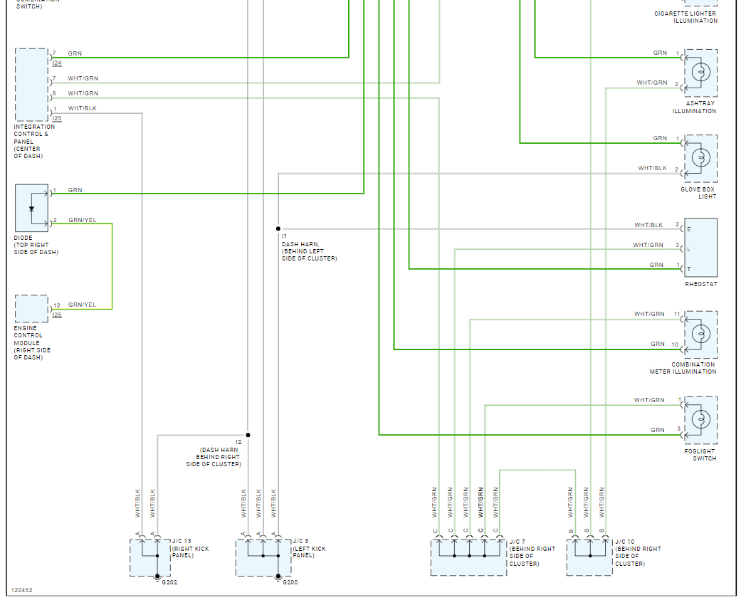

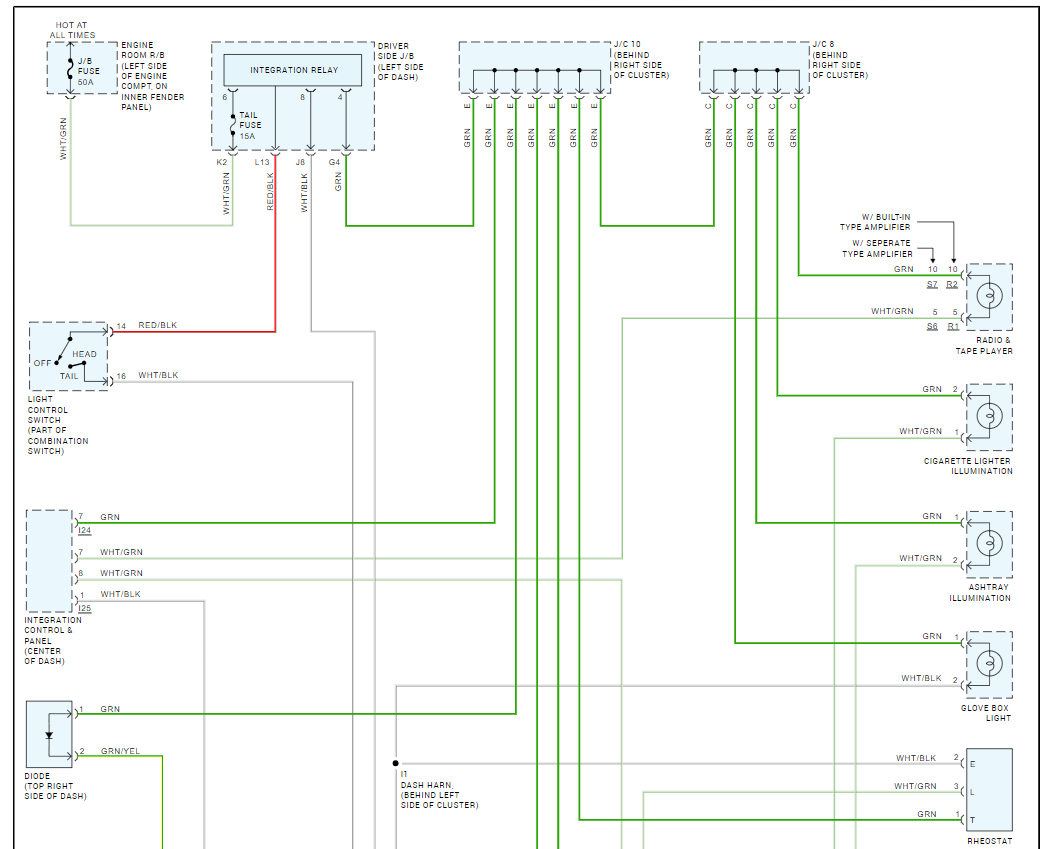

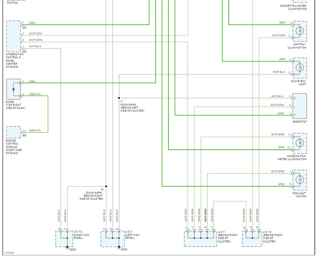

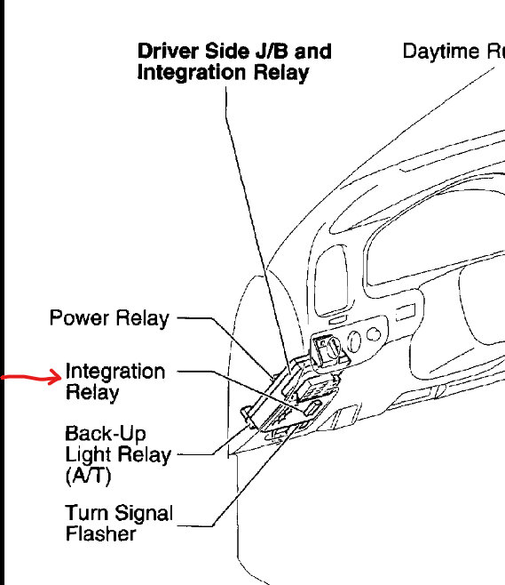

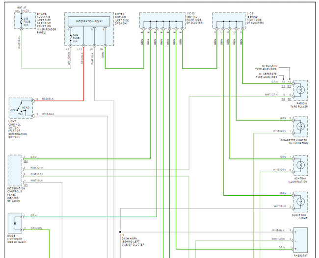

There is an integration relay that sounds like it is not working here is the location so you can sway it out, I have also included the wiring diagrams for the dash lights so you can see how the system works. Check out the images (below). Let us know if you need anything else.
