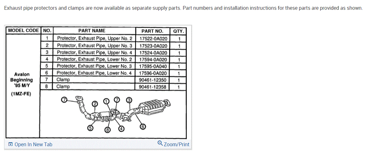

The most common cause of this type of rattle is either a loose heat shield on the exhaust system or a catalytic converter with a loose internal component.
The easiest thing to do is this. Take a rubber mallet and tap on the exhaust to see if you can recreate the sound. Do this when the vehicle is cold. Have a helper listen to see if he can identify what is causing the noise.

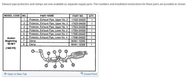

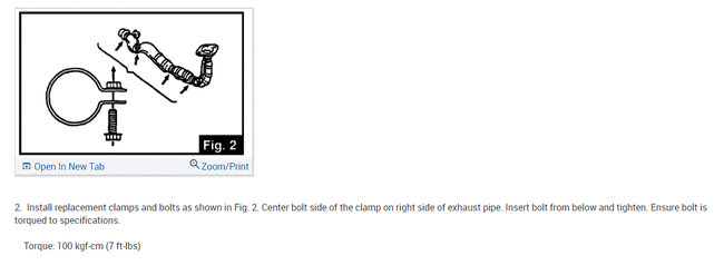

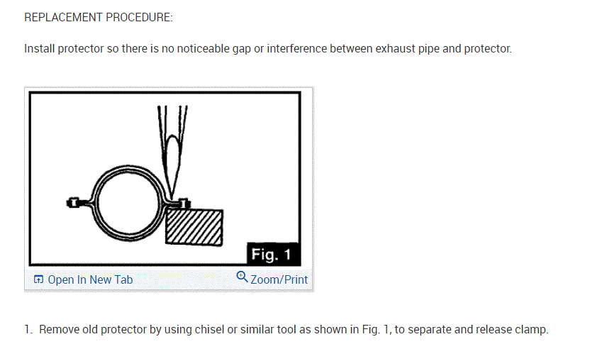

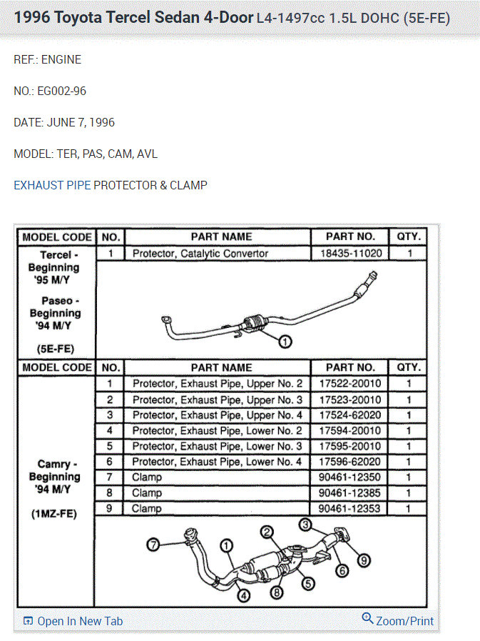

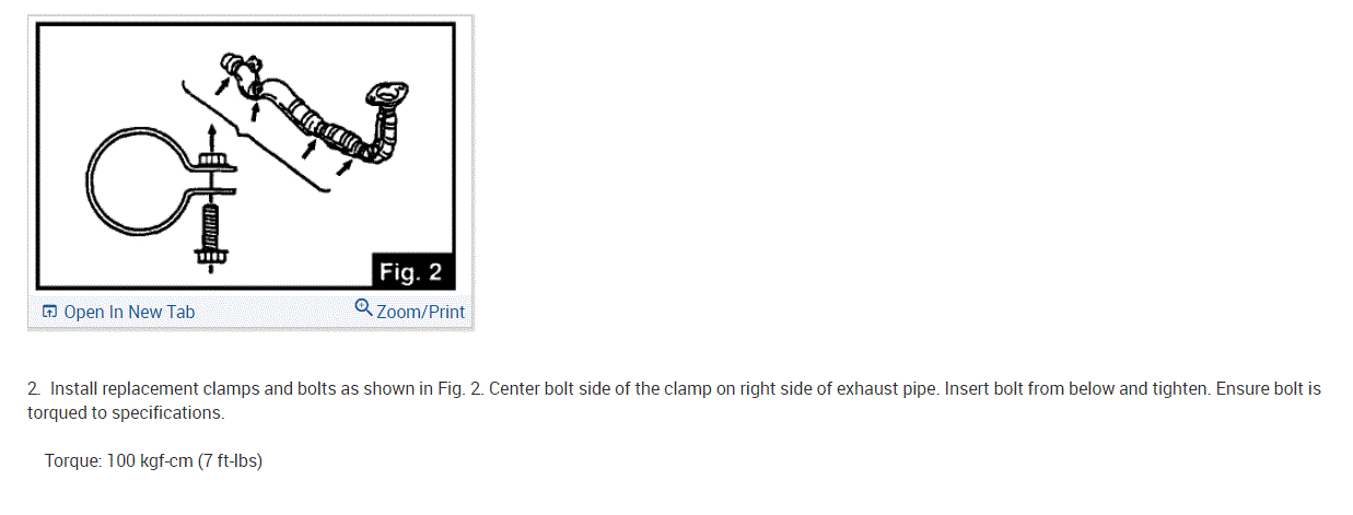

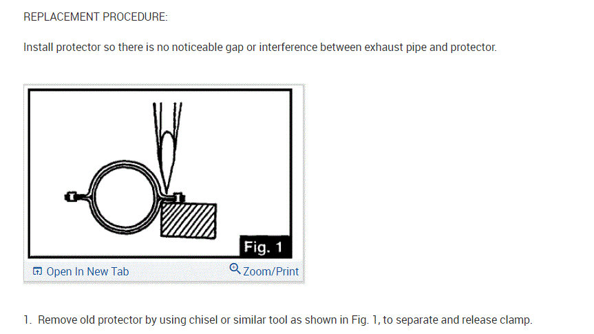

I was able to find a technical service bulletin (TSB) related to the heat shields making noise. I attached the information below. The TSB explains what to check and how to fix the problem. I have a feeling this is the problem.
I hope this helps. Let me know if you have other questions.
See pics below.
