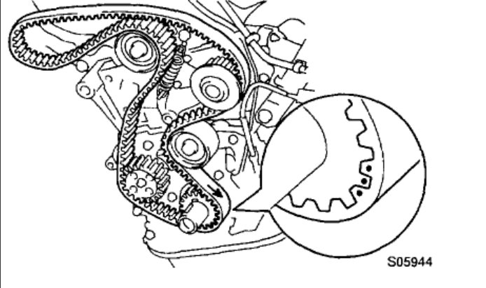

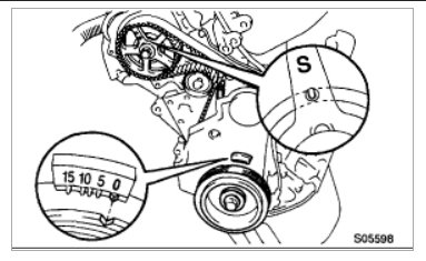

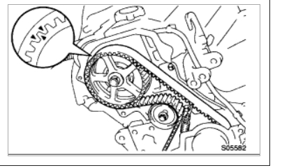

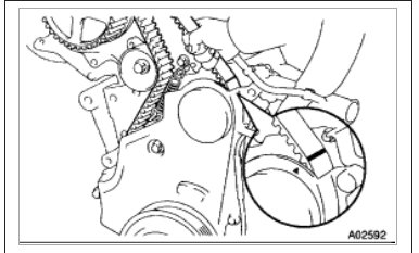

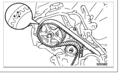

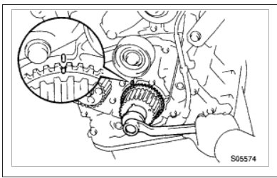

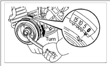

Ya he missed the timing belt timing by one or more teeth. Please disassemble to recheck the timing here is a guide to help you see how to do the job right.
https://www.2carpros.com/diagrams/toyota/camry/2001
Here are diagrams below as well

Yep he sure did once we took it apart you could see the problem, all good now thanks for your help. This site is great.
