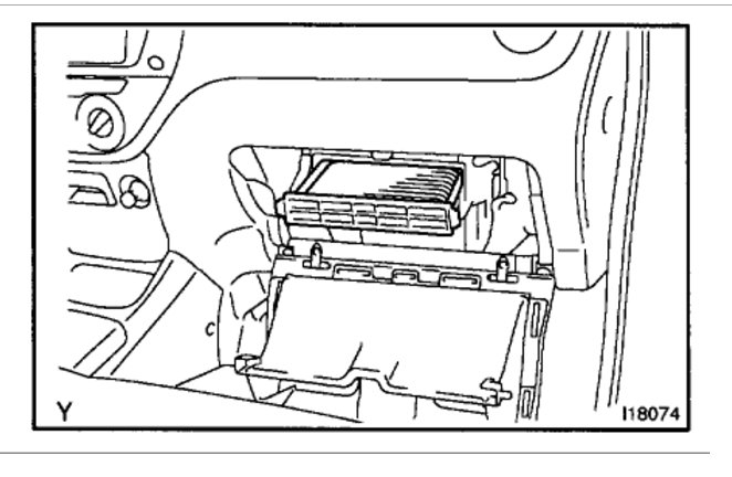

I need Instructions on how to Replace my Cabin Filter, and the location for that filter.
Jun 4, 2009 at 8:04 PM
BLUELIGHTNIN6
  • 16,542 POSTS

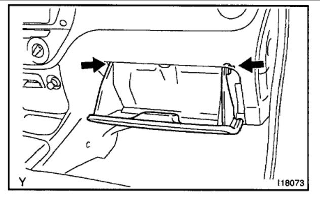

Your cabin air filter should be located in glove box , behind damper. Open the glove box door and slide off the damper. Push in each side of the glove box to disconnect the claws Push down on tabs and open the filter door Remove the filter from the filter outlet When installing the filter in the filter outlet, follow the instructions indicated on the label

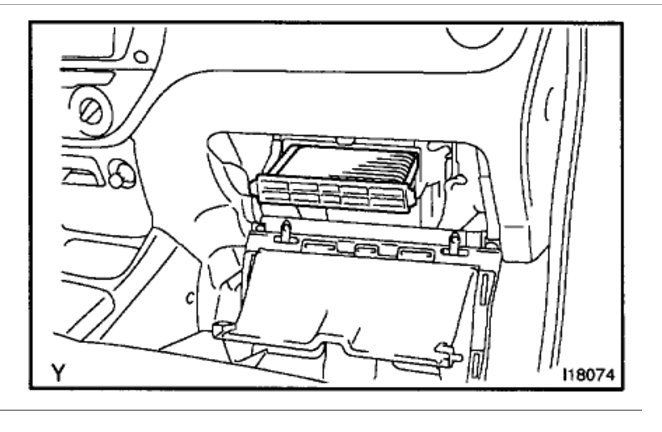

The cabin air filter is located behind the glove box, here is a guide and some diagrams (Below) that will help you get the job done, You can get the filter from Amazon.
https://www.2carpros.com/articles/how-to-change-an-air-cabin-filter
