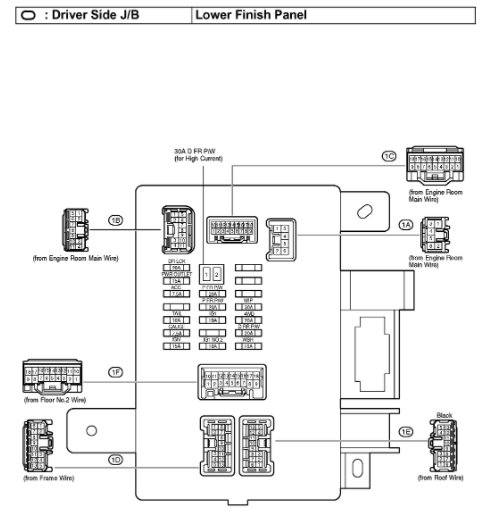

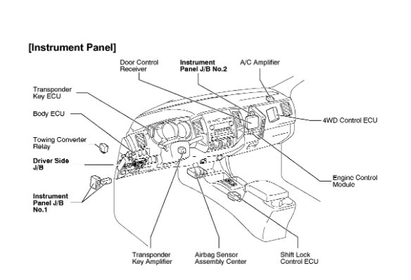

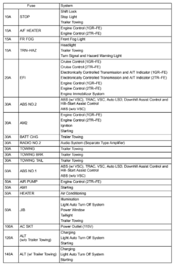

My Compass and Temp gauge are not displaying. Is it a fuse but I don't know where they are can you help me test them as well?
Jan 13, 2010 at 8:16 PM
DANNY L
CERTIFIED EXPERT
5,648 POSTS
Hello, I'm Danny.

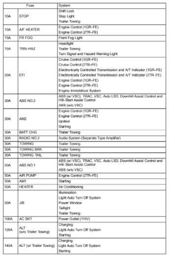

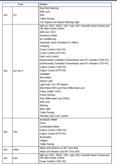

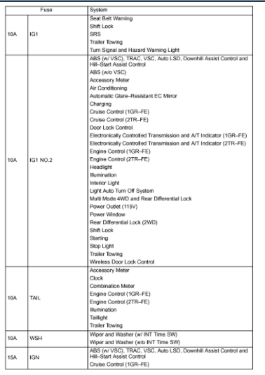

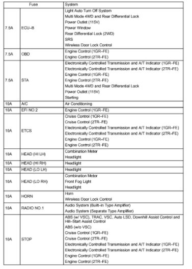

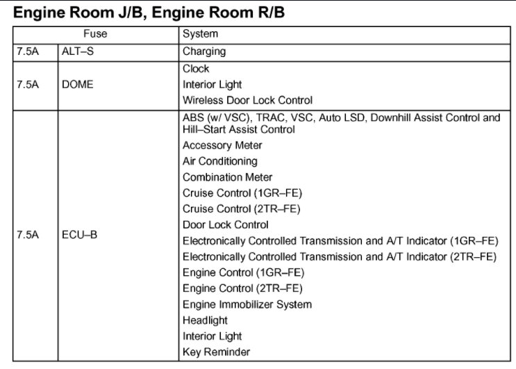

Here is the information you requested. Here are a few tutorials for you to view on how to check and replace fuses:
https://www.2carpros.com/articles/how-a-car-fuse-works

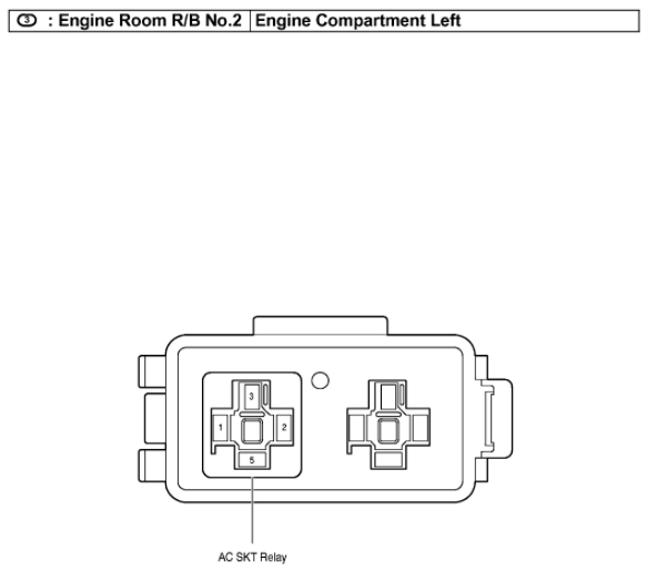

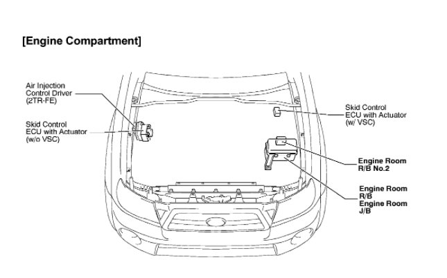

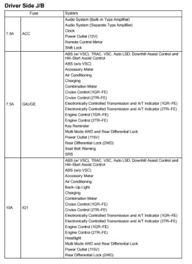

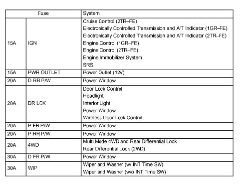

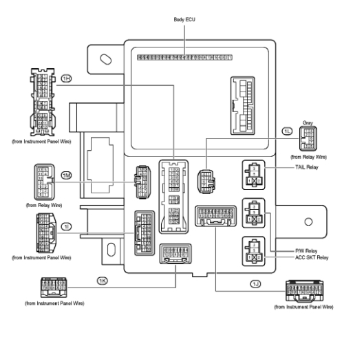

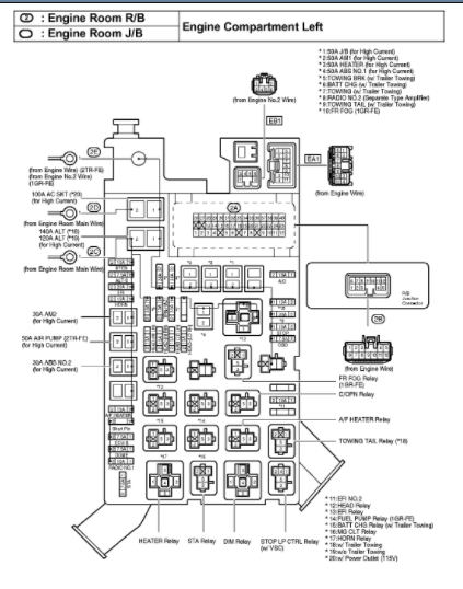

I've attached pictures below showing the fuse and relay locations on your truck. Hope this helps and thanks for using 2CarPros.
