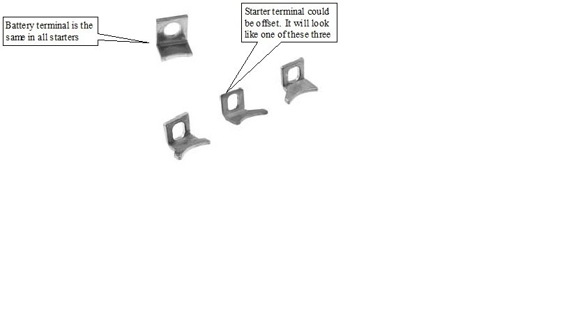

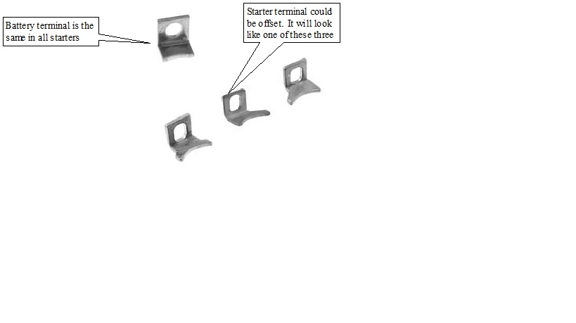

Most people just replace the entire starter, but there are repair kits available in hardware stores and farm and home stores. If you have a starter / generator rebuilder company near you, the contacts are available for about three dollars each, but there's a problem. Every one of these starters on Toyotas and Chryslers uses the same "battery" contact. The second contact, the "starter" contact, has three versions and there is no way to know which one you have until the starter is disassembled. These starters all interchange over multiple years, and they changed to shape of the second contact for some years. When you buy a rebuilt starter, it could have originally been used on a vehicle many years older or newer. To solve this, the hardware store kits come with four contacts. You use the "battery" contact, then you use the one of the other three that matches your old contact.
The next problem is there are three different length plungers with the contact disc. Two are used on the starters used on Chryslers. Those two kits are listed in the stores by model year, but again, if the starter was replaced years ago, you can't be sure you're buying the right kit. Fortunately the plungers don't wear very much so it's okay to reuse the old one.
Toyota uses its own plunger with a different length shaft from either of the Chrysler parts, but you can't buy that anywhere except through the Toyota dealer's parts department. They charge a real lot more for it than the entire kits from hardware stores. Chances are you don't need a new plunger, so you can buy either kit for a Chrysler starter and just use the two contacts you need.
