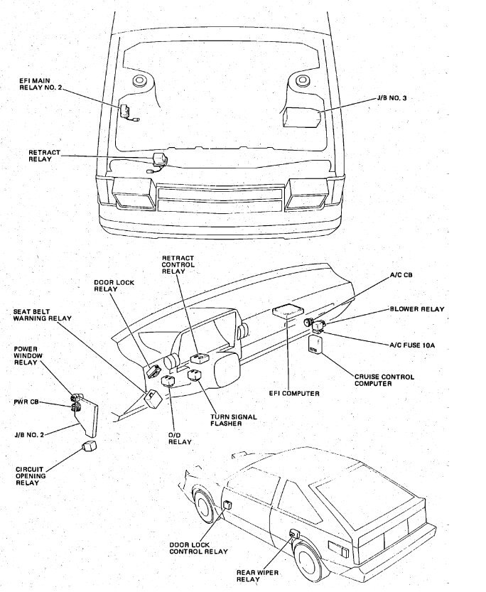

I would check the fuses first here is a guide to ehlp and the fuse locations as well.
Also, I would swap out the main EFI relay which had problem in this car. Check out the images (below). Please let us know what happens.
