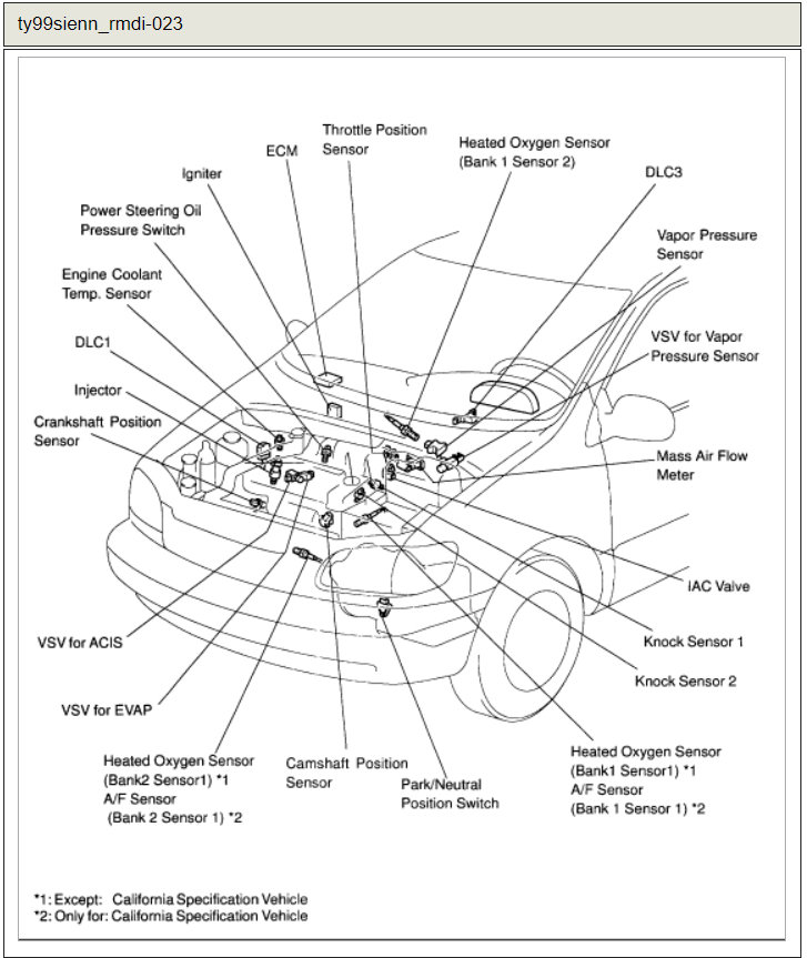

i check the trouble code for my sienna and its calling for o2 sensor malfunction its say bank 2 sensor 1
my question the location of this sensor is the one by the firewall or the one on the radiator side i want to know so i can get the right sensor

I had an error code that indicated bank 1 sensor 1 A/F sensor was bad. I have purchased a new sensor, but not sure form the Chilton Diagram where this particular sensor is located. Could you help with giving a way to locate? I found 2 different sensors but the one under the car sounds like it might be the O2 sensor, whereas the one under the hood has a different connector.

Bank 1 Sensor 1
Bank 1 is usually the front bank of cylinders on a transverse mounted V6 engine.
The one on the exhaust is the heater oxygen sensor could be 3/4 wires.

on exhaust next to the firewall

It's the one located after the converter on the rear bank. It just unplugs and then threads out.
