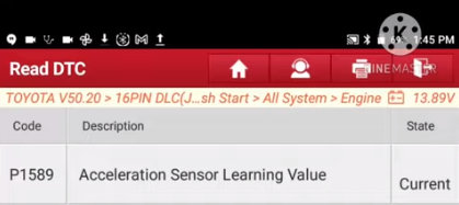

I am getting that same problem on my Toyota Vxy and I can't find a solution.

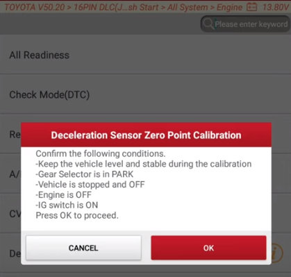

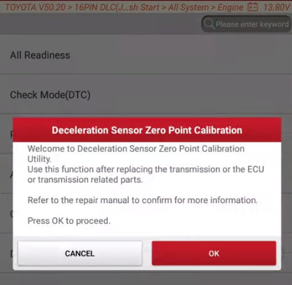

P1589 Acceleration sensor learning value.
It relates to the multi axis acceleration sensor. This error occurs during deceleration testing, when the vehicle is almost at a stop - but the acceleration sensor in the vehicle doesn't register that deceleration correctly.
You will have to use a suitable scan tool to carry out a 0 point learning procedure.
See images below.
A video showing how to.
https://youtu.be/zZ2Jtsv9-EU
Please let us know how you get on.
Cheers, Boris
